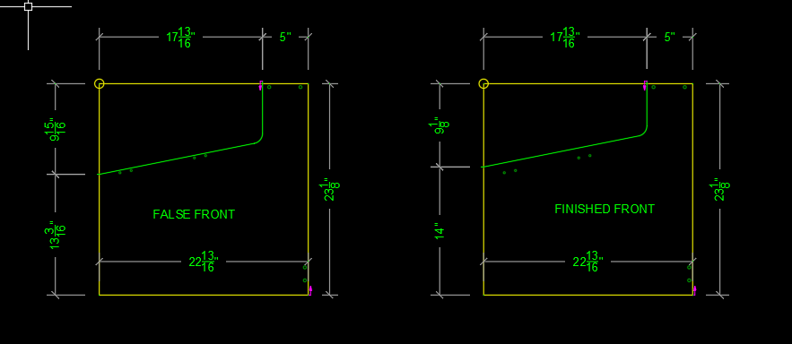

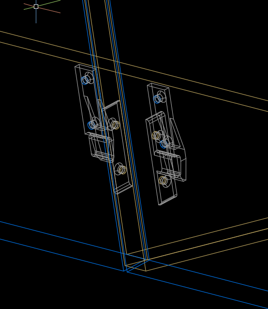

When using the regular False Front, the Scald Shield and the Scald Shield Route line up and everything is fine.  But when we switch to the Finished Front and remove the False Front it pulls the machining for the Scald Shield Route forward by the thickness of the False Front but it doesn’t move the Scald Shield panel and hardware.  This means the bottom of the cabinet is deeper and the hardware machining doesn’t work since it is now “set back” that thickness dimension.
In looking at it we don’t think that the Scald Shield Route should move at all based on the options of Finished Front vs False Front.
