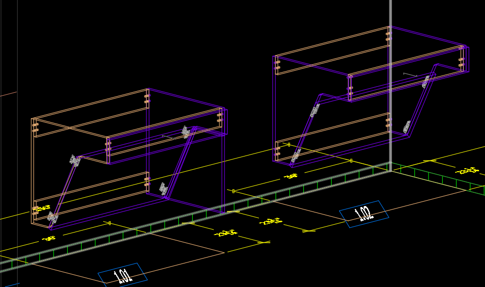

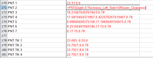

 Does anyone have an idea on how to fix the machine token that does the ADA sink side panel cut for the right side machining? Currently if you do a finished right side and an unfinished left side the machine token does not cut through the material as it would be thicker (melamine at 0.77" and PL-Liner at 0.805") because it shares the same machine token for both side in spreadsheet. all of the PNT call out "Thickness_Left_Side+G!Router_Clearance" in the formulas.
If you change the left side to a finished end everything works, but that adds to material cost. Then if the left is finished and the right side is unfinished the machine token cuts to deep.
One minor issue is the right side machine point needs to change from a 1 to a 2 for the machining to be on the correct side of the part as well (liner side of material).
