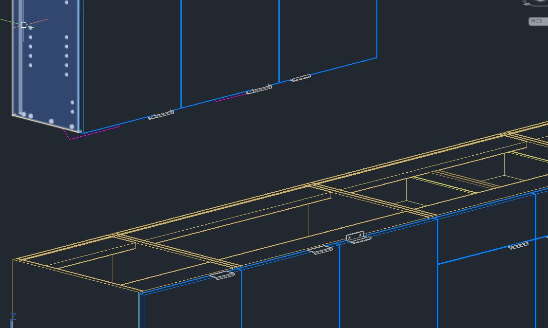

Has anyone spent the time and effort to setup and create Tab Pulls for doors and drawers?  I am talking about the full setup of 3D parts, 2d drawings, and machining as well.  I created the hardware part so we can select it and it shows on the reports but I want to go further and get the drawings added and even do the machining as well.  I made the 3d part and 2d section/elevation but I am finding there are rotation issues now since these are back mounted and directional essentially.  So, the setup used for say a wire pull doesn’t work.
