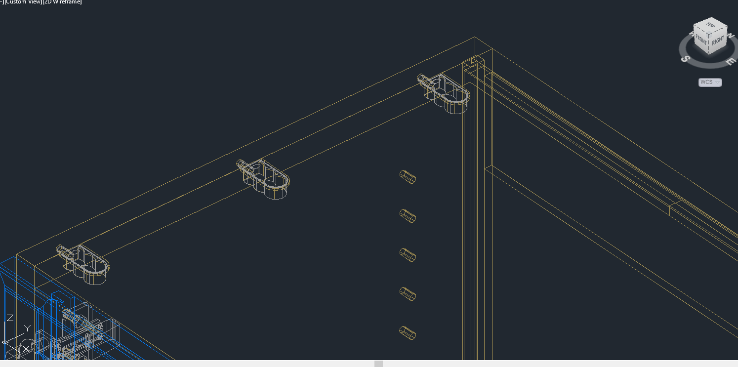

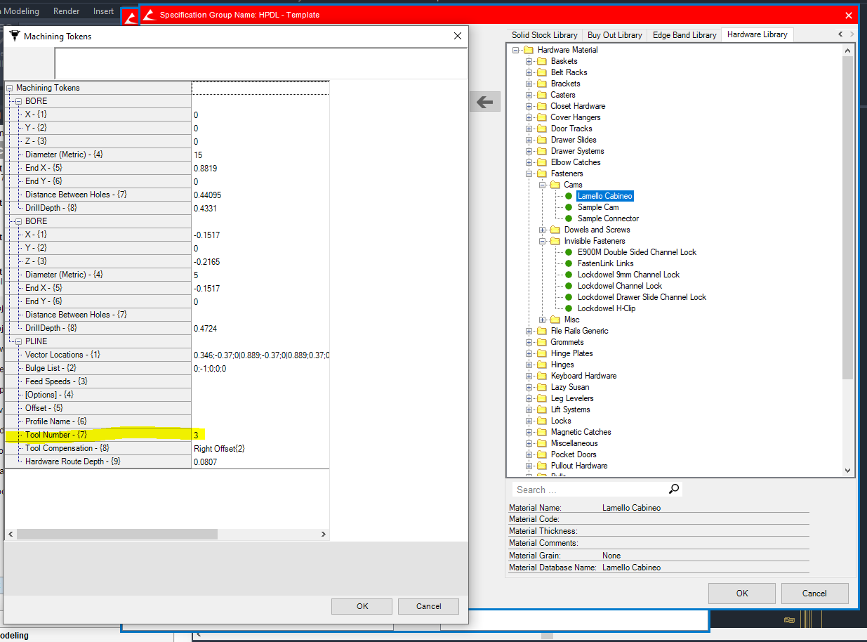

I figured out how to use the Cabineos and successfully have the edgearray machine token and all that. But when it goes to machine these, it is picking up our 5mm and trying to bore the 15mm hole with that bit. I cannot seem to find a place to change it to rout and setting a different bit like our 1/4" or 3/8" compression. We do not have a 15mm drill bit but can get one. But where would I even set that tool number? As you can see, it is using the 3/8" bit for the pline which is for the Cabineo cap and it is giving me the option to change the tooling there. See the pictures below.
