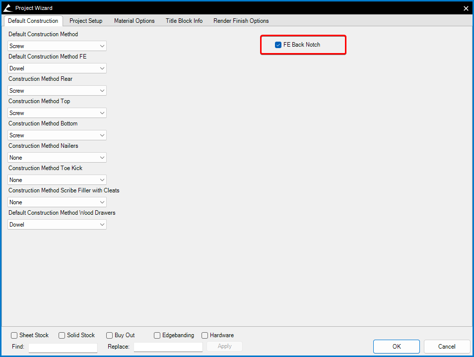

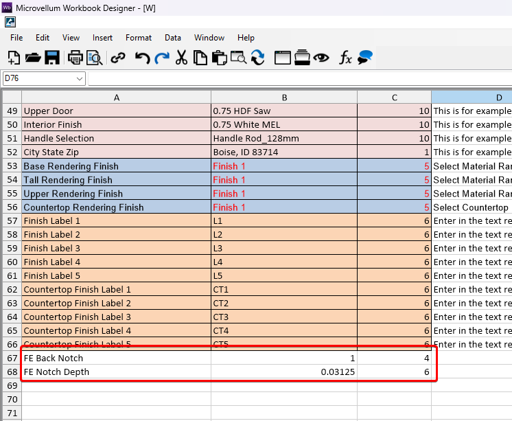

  1. I created a feature check box in Project Wizard

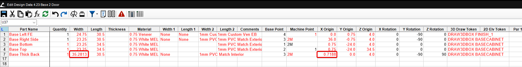

  2. I created conditions in the product design data to update the cabinet back width and offset depending on the FE condition

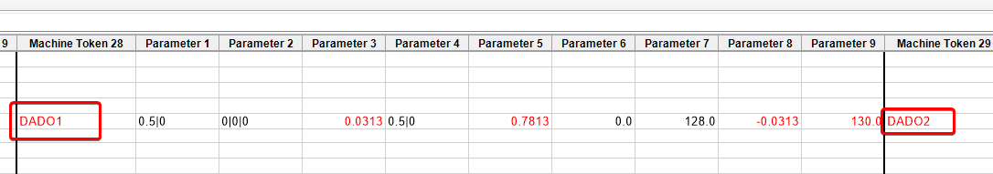

  3. I also created conditional dados driven by the feature check box

  1. The Wizard settings can be updated in the library template
  2. But, I'm a bit fuzzy on the best approach to update the product design data for all of the other products
