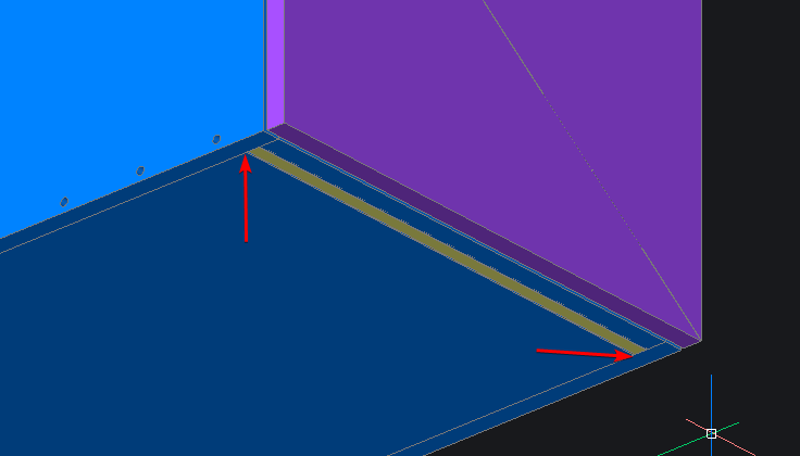

For our toe kick lighting, we create a dado along the entire length of the run off cabinets and install a recessed light extrusion.
For the MV strip lighting insert, it only creates a dado on the bottom outside (image below)

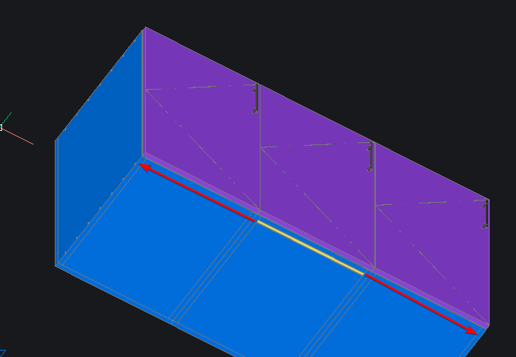

I am looking for an option to continue the dado into the left and right side panels and onto any additional cabinets in the run.
I understand the I can apply the strip lighting insert to each cabinet, but I am looking for a more streamlined solution.
Do associative machining tokens work across multiple products?
For example: a strip light insert (sub-assembly) creates machining dados on a series of 3 cabinets?
