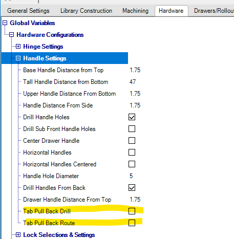

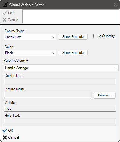

We / I added a Global Toggle Option to TURN the back RABBET ON or OFF and DRILLING ON or OFF

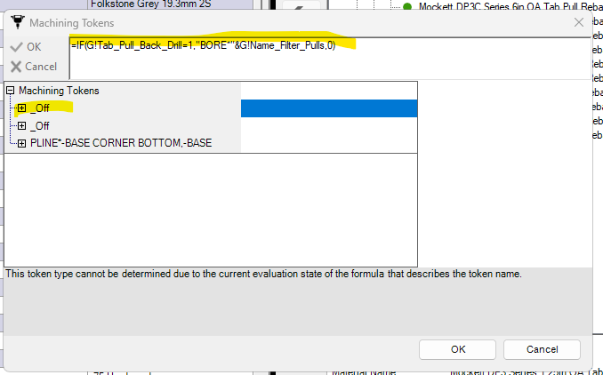

For the DRILLING of the pilot holes:
=IF(G!Tab_Pull_Back_Drill=1,"BORE*"&G!Name_Filter_Pulls,0)

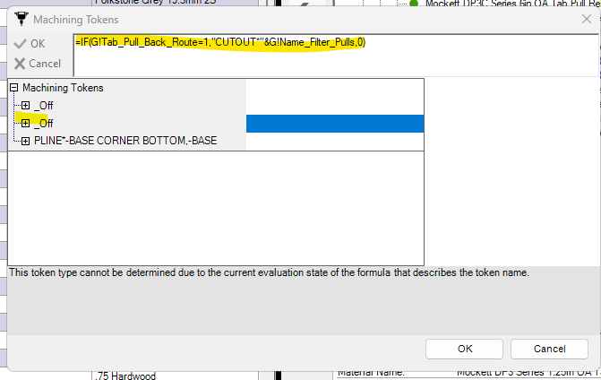

And for the BACK RABBET
=IF(G!Tab_Pull_Back_Route=1,"CUTOUT*"&G!Name_Filter_Pulls,0)

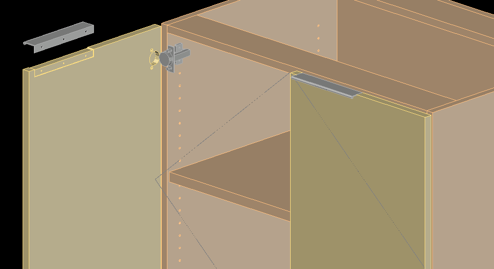

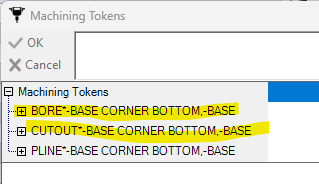

And if we TOGGLE both ON then ...
The TOKENS are ENABLED:

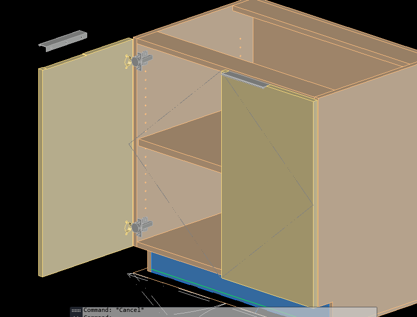

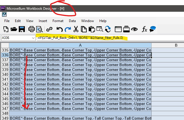

And the RESULT:
You can QUICKLY add the LOGIC via the H table
