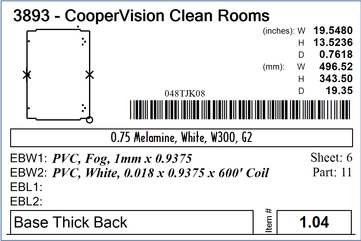

I am looking for some help on part labels. We occasionally have parts which require different banding on parallel edges and am trying to find out if EBW1, EBW2, EBL1, & EBL2 are always located in the same position on the label. This hasn't been brought to my attention enough to determine consistency. In the image below the edge on the right gets the 1mm Fog PVC, the edge on the left gets the .018" White PVC.
