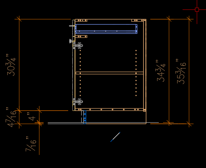

Base or Tall Cabinet ... Cabinets for a big project are going in BEFORE flooring ... so customer whats all the BASE and TALL cabinet to have 7/16" extra height at the FLOOR.
So instead of a 34-3/4" cabinet with a 4" toe kick ... They want a 4-7/16" Toe Kick and thus a 35-3/16" Cabinet Height.

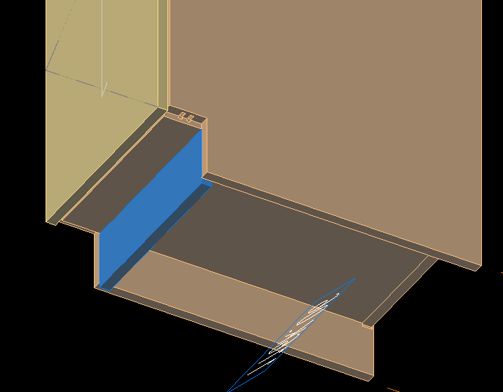

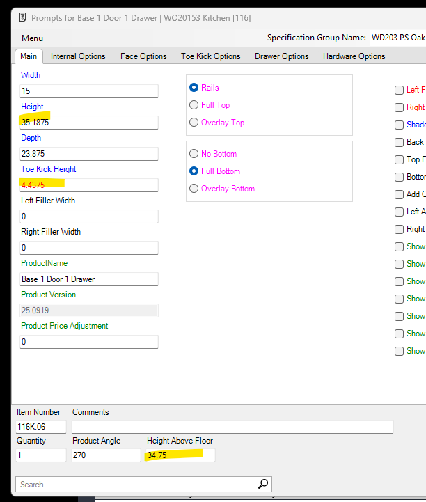

I put in the 35.125" height, 4.4375" toe kick height and THEN 34.75" HEIGHT ABOVE FLOOR.

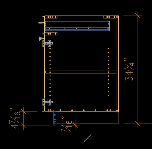

What happens is the TOE KICK moves down fine ... the SIDE get messed up and won't go BELOW the 0 plane. The Bottom is goofy and it's not right. The Toe Kick Notch CUT stays at 4.4375" .. the overall height is 34.75" not 35.1875" ... just all goofed up.
So ok ... then I'll just MVMOVE it down the 0.4375" in Z. Upon REDRAW/REBUILD it messes up just like the other way.
Result:
