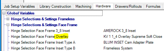

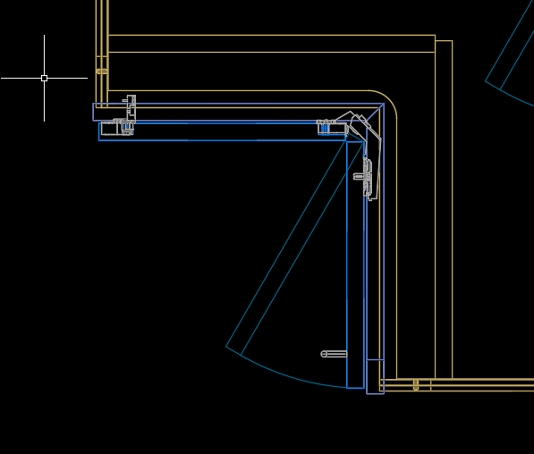

I am trying to setup 2Door Pie Cut Corner Face Frame Cabinets to be able to switch out the Hinges/Plates being used for these cabinets.  By default, all the Face Frame cabinets use whatever hardware is selected in the Global.   I need to be able to change out the hinges or even switch to frameless hinges (to get a hinge and plate) to get the proper opening angle.
In our current case and with most face frame hinges the max opening angle is 107-120*.  But in our opinion and desire we want to use 165-180* hinges.   The hinge type I am being told also change based on the overlay.

So, the question is what is the best way to change hinges in a 2Door Pie Cut Corner Face Frame Cabinet?
I have considered adding a new Global to select the hinge.  But since it needs a hinge and plate, I would be looking at using the Frameless System selection.
Is there are good way to the existing setup without hard coding things?  I am trying to avoid this since we have 4 distinct lines of cabinets, and the hardware can vary based on price point.
