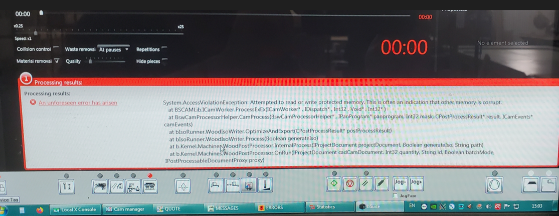

I have an inconstant problem with nested code for our Biesse Rover CNC.  Just recently when we create a work order and nest cabinet parts some sheets will not run due to errors at the CNC while others will run. What I did finally notice that the sheets that have errors have thick cabinet backs on them. If I re-nest just selected parts with cabinet backs I get the same error in the same work order. If I nest selected parts with no thick backs I don't get any errors with creating a new work order. If I nest Thick back only I do not get any errors with a new work order, but if I do mix select parts together I get the same error again. I need to create a new work order ever time. Seems I get mixed results by modifying an existing work order.
 The most confusing thing about this issue is it's not happening on every project that we process.
