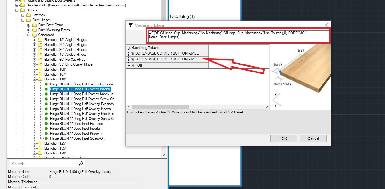

BORE Hardware machining token formula in newest Foundation Library
When adding BORE token to hinges, I am noticing the "*-BASE CORNER BOTTOM, -BASE" in the formula to turn it on. What is that? I have never seen it before and is it used for reports or something and need to stay in there? I am trying to have the reference hole drilled instead of our CNC doing it but don't want to screw anything up.
