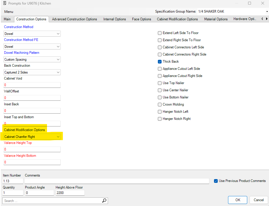

We have options in Microvellum to modify cabinets with a chamfered corner. However, I’m trying to determine the best way to add shelf-pin holes to the chamfered section when the cabinet has adjustable shelves.

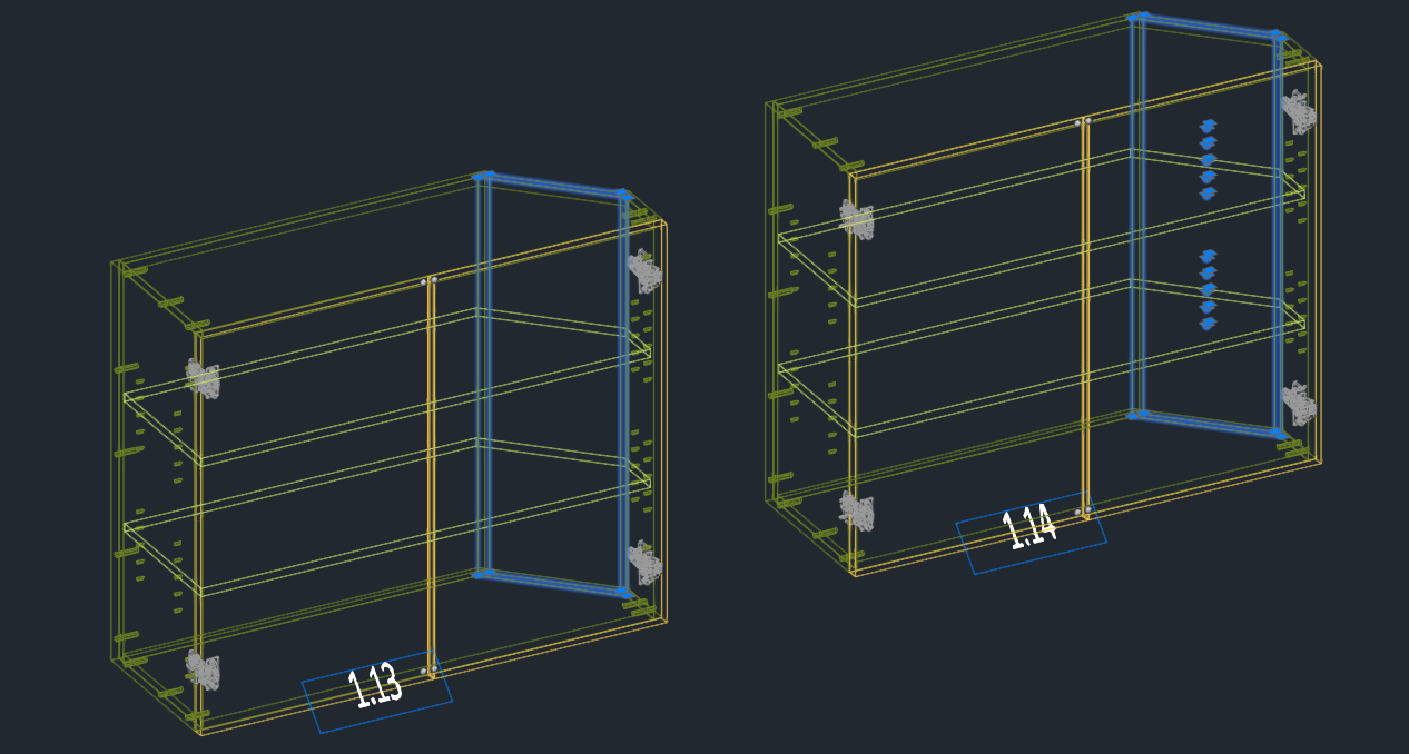

When the chamfer is large enough, the adjustable shelf loses a significant amount of support at that corner. In those cases, I feel the chamfered piece should also have shelf-pin holes to properly support the shelf.
Currently, I am handling this manually by using Edit Part in 2D and assigning the required machining. Is there a better or more automated way to have the shelf-hole machining added to the chamfered piece, preferably based on the adjustable shelf locations?
