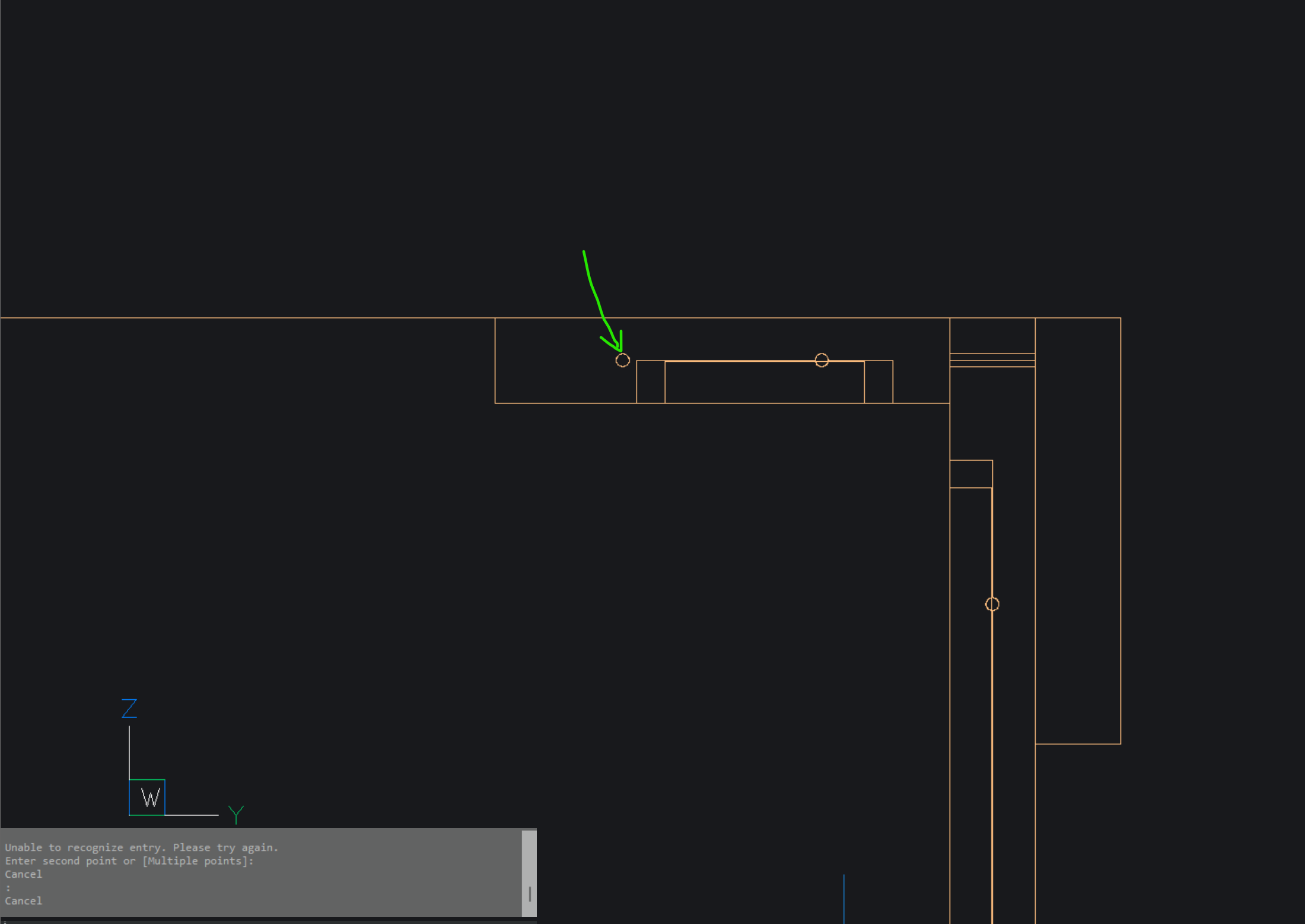

After a while of digging through topics & videos, I finally figured out how to change our screw diameter from 5mm to 3mm! I wouldn't be surprised if the answer for this next roadblock is right infront of my face but I am unsure of how to adjust locations of screws..
We are using a Dado/Screw Construction Method, and the screw locations seem to be based off the material thickness rather than placing them in the center of the dado's notch itself.
I hope this makes sense! appreciative of any insight on this
