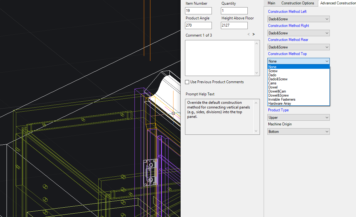

Construction method type doesn't seem to be working
Trying to turn off the construction method for tops only. Its not listening per unit. so tried it in the wizard for the project and that didnt turn it off either. I have a feeling its because i set them all up with a chamfered top and thats overridden some things but who knows and its not doing it to a satisfactory solution so id like to turn them off manually and cut them on the saw. Ill turn them all off manually as by the time support gets online ill have lost my whole day.
So the Global construction method is overriding the construction method that you set in the prompts at the moment. I dont know what build this drawing was started on but i'm on 26.0430.
