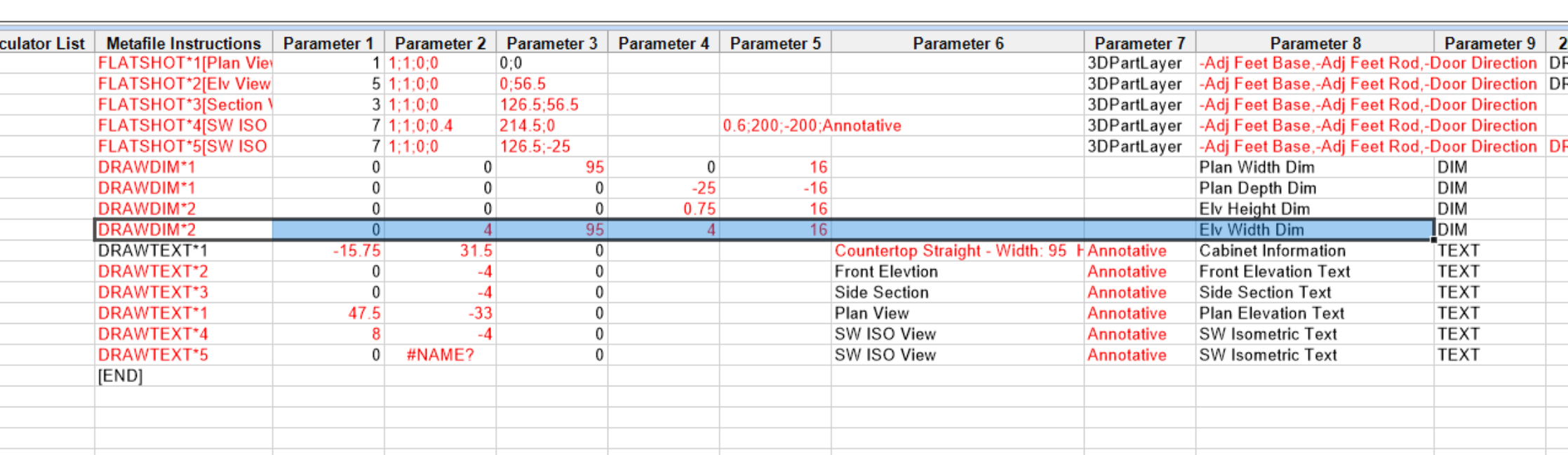

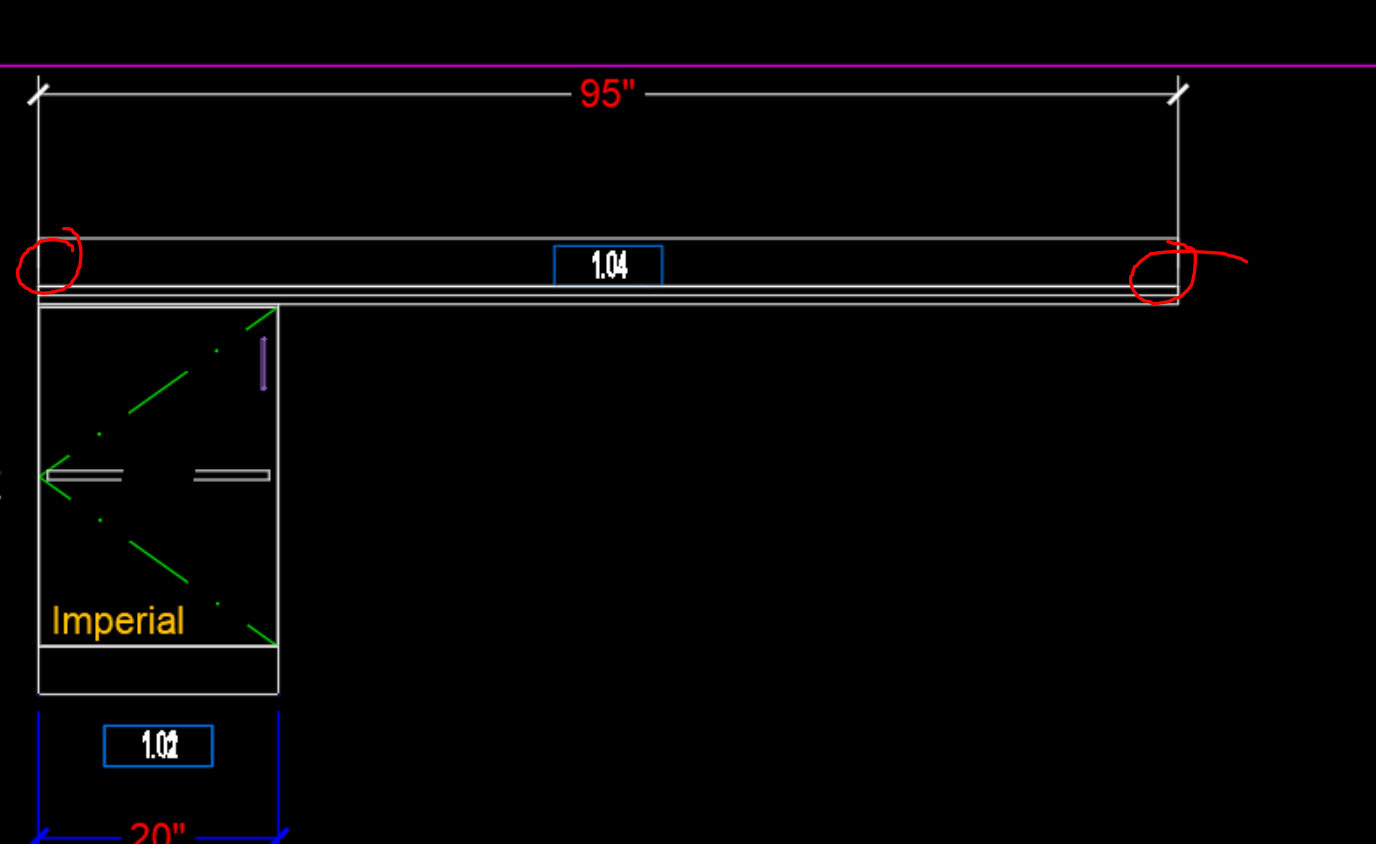

What's the best way to modify the elevation width dim on the straight countertop product? I just want it to show up in blue on the same layer like the rest of my dimensions, but for whatever reason any changes I make don't affect it. I'd also like the start of the leader to be on the top of the backsplash instead of the top of the countertop material. Even if I delete the tokens, it still shows the dimension. Forgive me if this gets posted every week, but the search bar won't let me search specifically for words used in the posts which is a bit frustrating.
