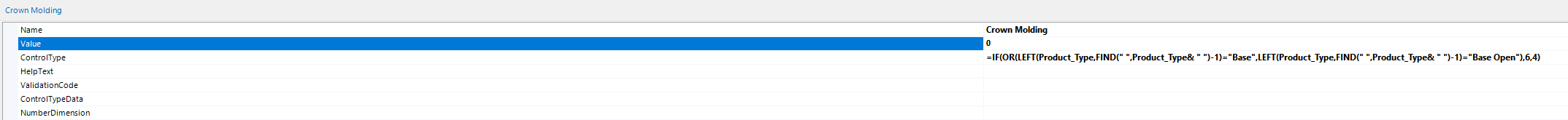

Crown molding not listenign to global
I believe there may be an error in the library for all the cabinets atleast my face frame library is like it, i only updated the other day. All of the crown molding prompts to turn on from the globals are hard set to just 0. In all categories, Tall, upper, base. Thanks
Does anyone have the formula i can copy please as i think it needs to be an IF one based on tall or uppers and i'm not good with that complexity of formula yet. Thanks!
Update: i stole the formula for base molding and changed what it looked for from "base" to "crown" and that seems to have worked for now: =IFERROR(INDIRECT("G!"&LEFT(Product_Type,FIND(" ",Product_Type& " ")-1)&"_Crown_Molding"),0)
