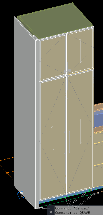

Is there an existing CUSTOM 5pc DOOR in MV that would be like this? Or one that could be modified from.

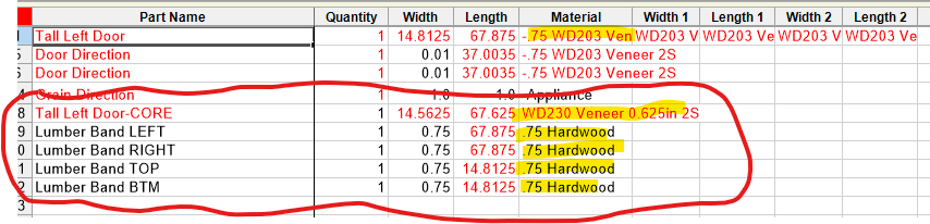

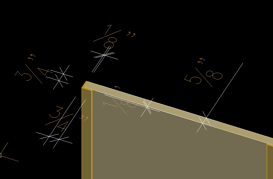

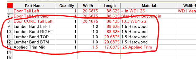

This is some more detail ... the 3/4" x 3/4" on the perimeter would be solid lumber that we would like to get linear solid wood footage on a report. The 5/8"  door core would be veneer and nested on the machine (Door Size - 1/4" for the 1/8" per side banding)
We also do this same time with 1" x 1-1/2" perimeter lumber and a 3/4" veneer door core (Shown below as well)

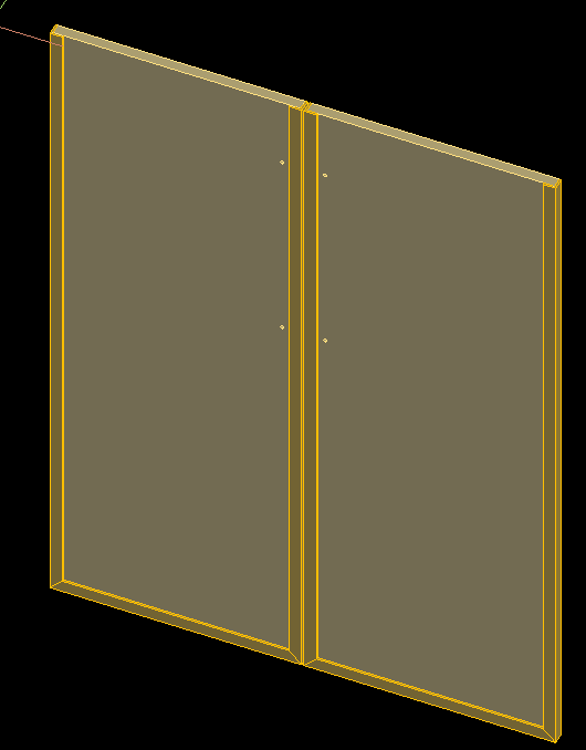

This is how we've done this before in the past. (This being in FL ... and I'd like to attempt maybe a 5pc door in lieu of this)

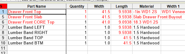

And this is how we'd do it in CL ... this being the 1" band and 3/4" door - but the same thing
and a drawer example
