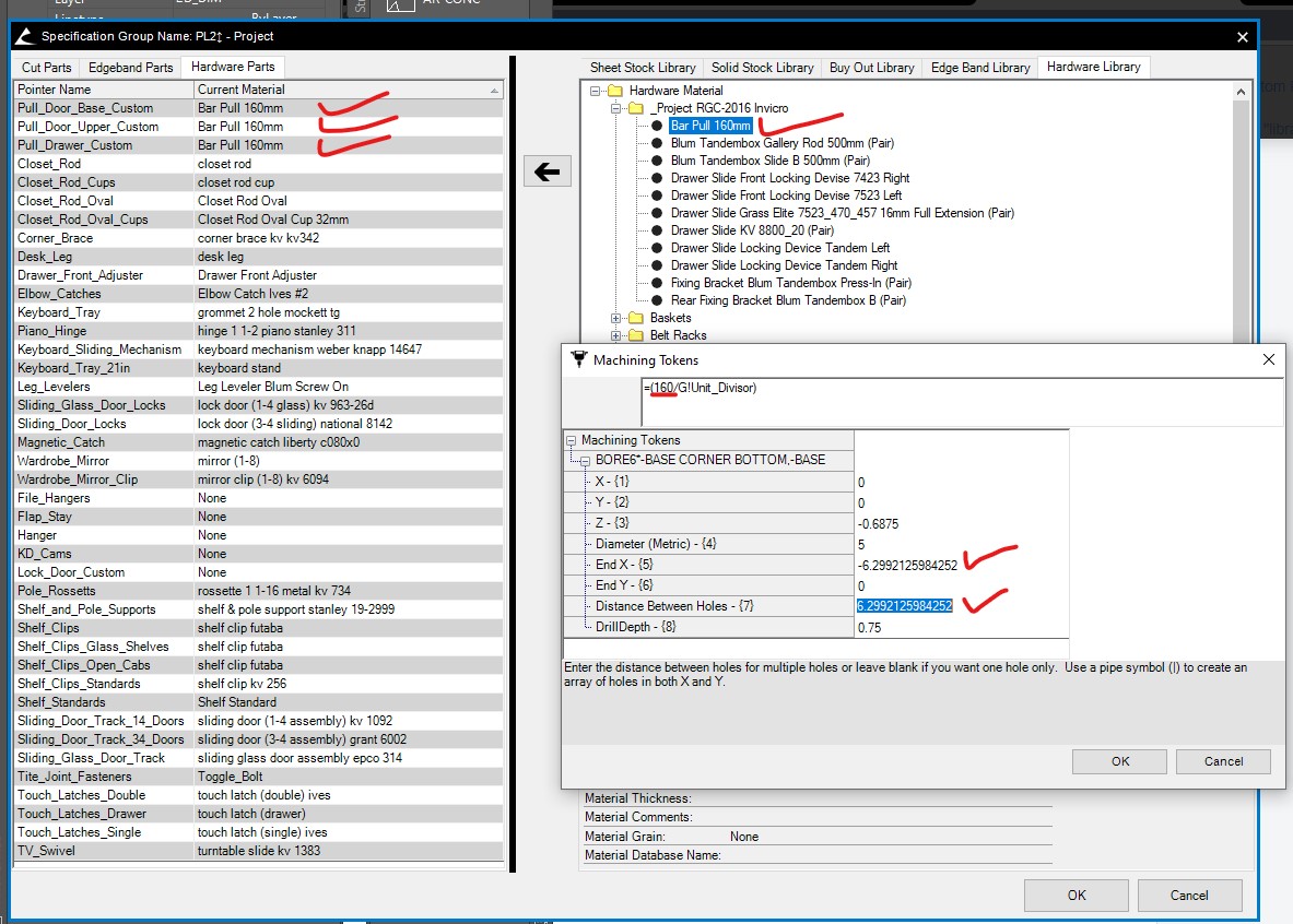

Custom Pull holes off center on drawers
Need to drill holes for a pull with different center to center distance than what is available in the library. (160mm)
- I change pointers to Custom Pull
- Copy an existing Pull to project level
- Modify machining token for pull
- Apply modified pull to Custom Pull token

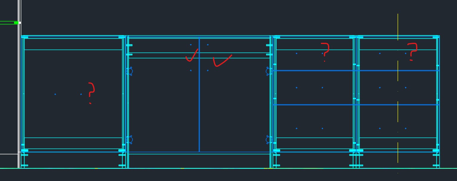

Holes drill at the correct distance however on the Drawer Faces they're off Center.
What am I missing?
