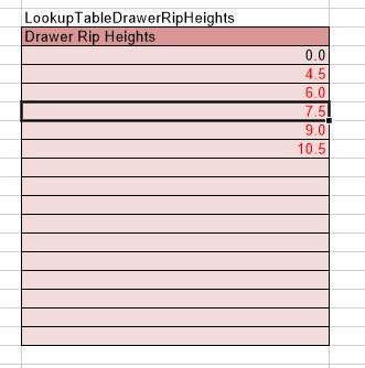

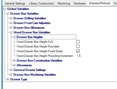

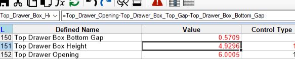

Using the 0902 library, drawer heights not using prompts from Globals or lookup table. Not really sure how else to set this up, but it appears that the formula that calculates the drawer is just a basic formula. Shouldn't it be a VLOOKUP formula is that is the option selected in the Global Variables? We use a dovetailer and send cut lists out to the shop so we don't have the luxury of just cutting these on the CNC.
