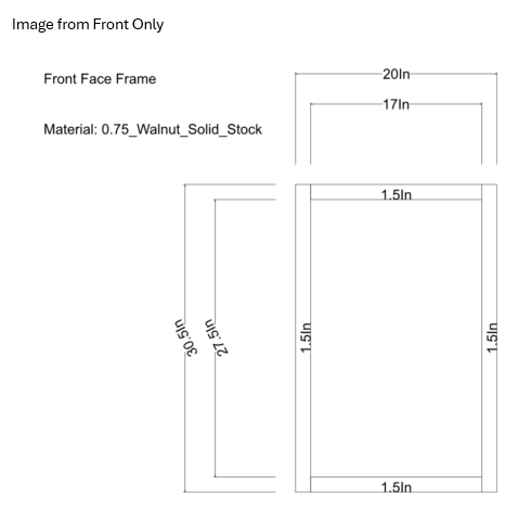

Has anyone seen this with the Face Frame image report?  It works perfectly when we just want a front face frame.  However when I add an Applied Left or Applied Right (or Both), the images start to stack.  I've reviewed newer versions of Foundation Library, and our report is matching, minus an initial databand using specification groups.
Report with Cabinet w Front Only (Good)

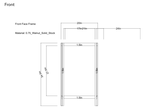

Image with Front Left and Right Face Frame (Bad v 1)
Front is getting Dims from Left (24") and right (21" stacking on 17")

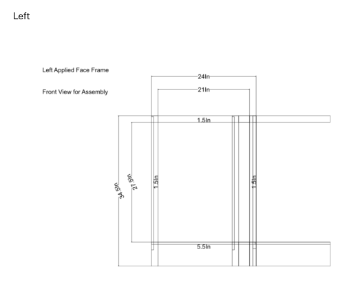

Left applied is getting images from what seems to be the right side.  Notice Toe to Floor (5.5")

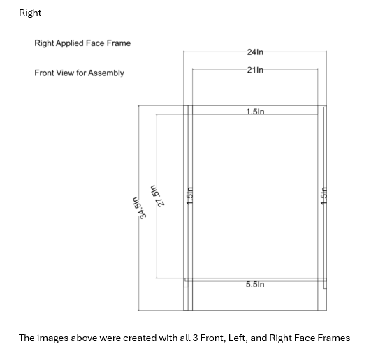

Right seems good

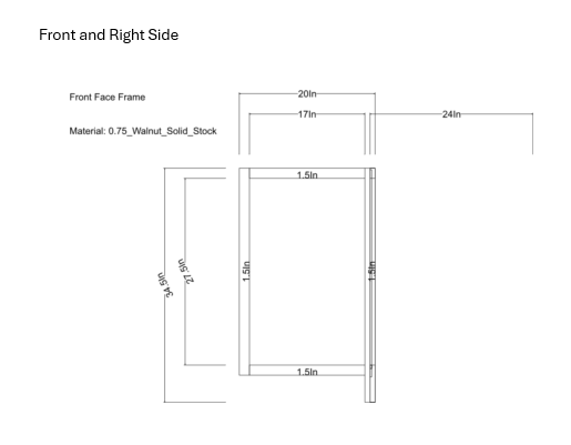

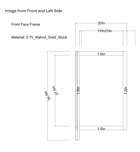

Similar things happen when its only Front and Left or Front and Right
