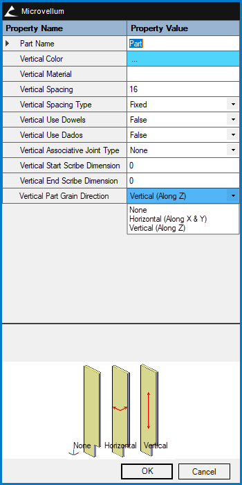

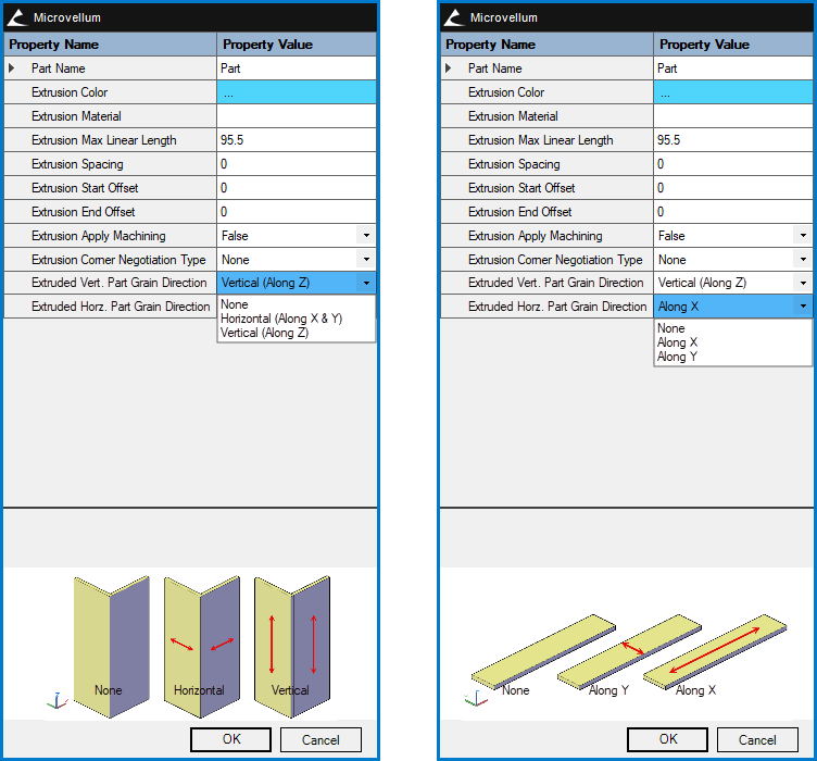

I would envision setting up some "governing rules" simply based on how parts are analyzed regarding X, Y, and Z rotations. Below are examples of what I'd envision could be added to the Smart Layer properties.
VERTICAL ENTITIES
EXTRUDED ENTITIES
