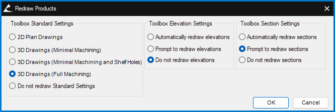

Expanding the Redraw Options to control elevation and section updates would be very helpful and give the user more flexibility on the fly. There are times when redrawing a product is really only needed for certain options or even just one. For example, changing a spec group might only require the 2D elevation to be updated, or you may add a cutout to a side and only need to update the 3D and section, or you just want to update the 3D only.
An expanded popup menu like shown below would be fantastic.
