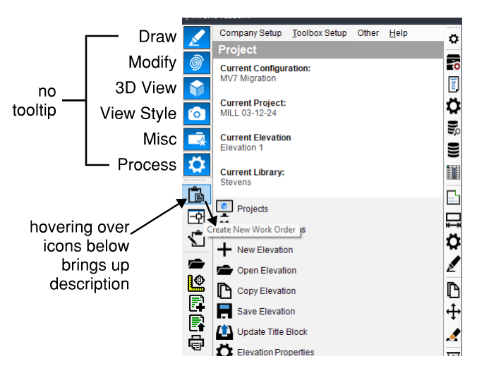

Simple tooltips are one basic example of a quick reference that ensures you're clicking the correct button.  I realized today that the blue toolbar in the MV docking station does not have those on the main blue buttons.  (It does on the ones below, once a blue one is selected.)  Maybe there is a specific reason or limitation that wouldn't allow them here, but generally, having icons with no possibility of a visible description for what they do causes unnecessary clicking and questions for many users.
