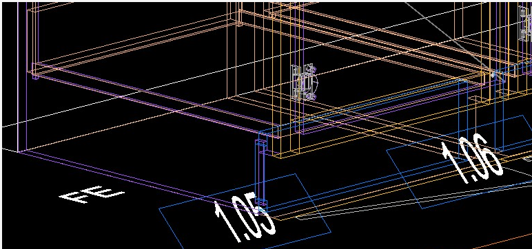

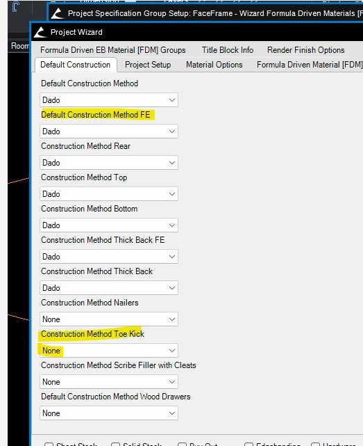

We would like to see the default construction method in the Wizard apply to both finished and unfinished sides of a cabinet for the Toe Kick/Nailer construction.
In the default construction method in the Wizard we have the Toe Kick/Nailer construction set to "None" so that we can butt joint or kreg them in place between the cabinet sides. But when we turn on a Finished End it is then changing the construction method for that end to be a Dado based on out FE construction method.  This becomes much more evident and an issue when doing dado face frame cabinets then when doing simply doweled frameless boxes.
We would expect that if the Toe Kick/Nailer construction is set to "None" that we should then maintain that even on a Finished end.
