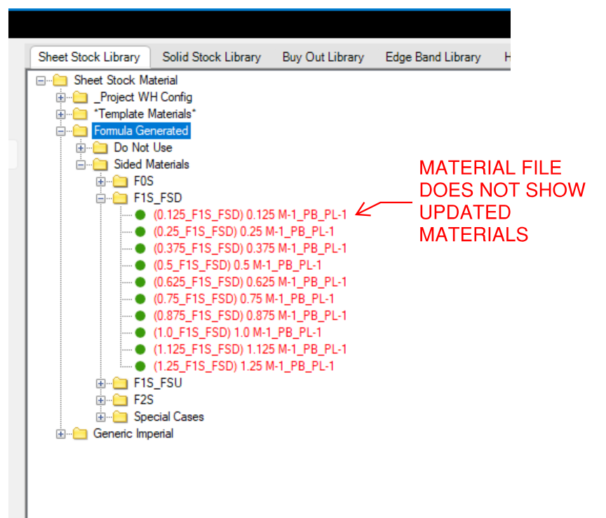

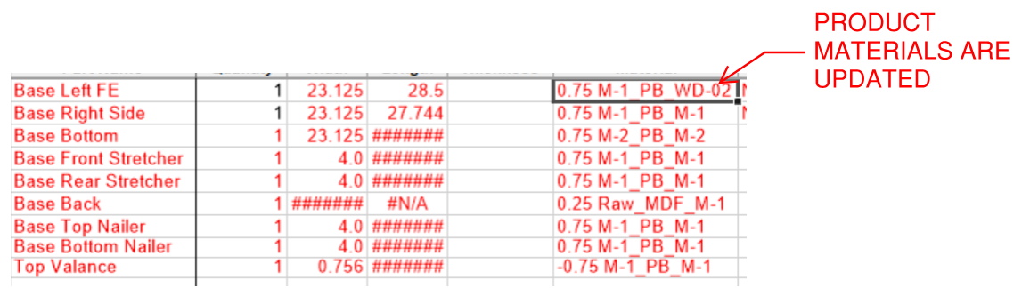

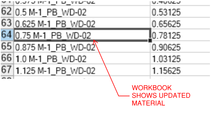

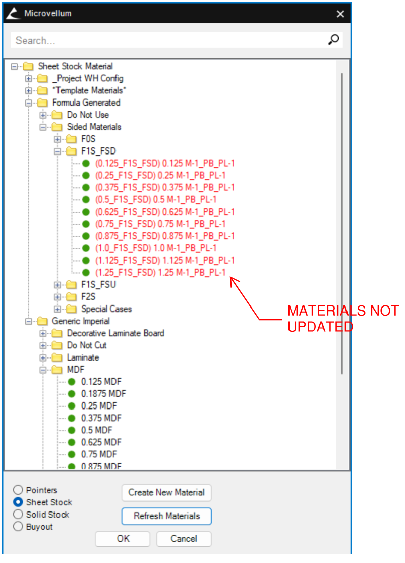

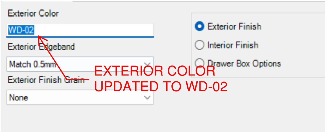

I've been working on setting up some new Materials for our shop and have run into a problem. When I update the callout for a FDM in the wizard, let's say to be WD-02, I cannot select the updated material from the material selection screen. If I open the selection screen via product prompts I should see the materials updated to show WD-02, instead I see the material's database name.
This wasn't always the case, we have a configuration on Foundation 23.1010 where it works fine, but we recently updated to 25.0703 where it does not work.
We're using SQL server, but I've tested this on a SQLCE version of the same library, and I get the same issue.
