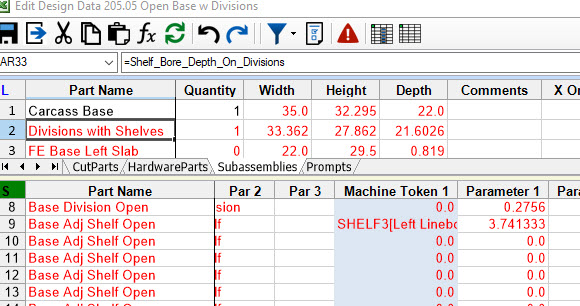

It might not be a game-changing thing, but I spend a lot of time in the spreadsheet view and having to hunt and peck through the columns to find the token I need to edit is a pain in the neck.

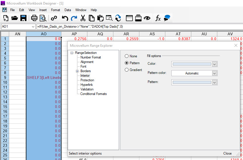

I took a few seconds to add a "highlight" color the token columns in workbook designer. Now, every time I have to go and tweak some little thing on a part, I'm not plowing through a thousand search results or scrolling left and right - squinting to see if I can find the bore or whatever token I was looking for.
Open the workbook designer - in this case the Divisions with Shelves Subassembly. Just highlight each token column and give it a color. I did two or three at a time.
Now, by default, that subassembly comes with light blue machine token columns.
