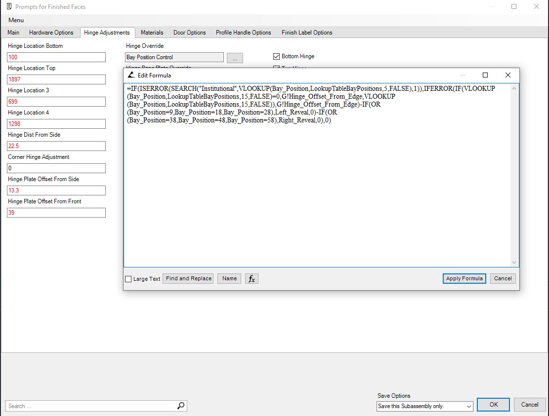

Hinge offset form edge doesn't adjust with gaps on doors
So I have the newest Toolbox and library and now whenever I set a reveal to the edge of the door the hinge hole moves with it to always be at 22.5mm to center of hole from edge of door. This is not the way it is supposed to work since the 22.5mm should be from edge of cabinet. In my previous version of microvellum the hinge hole would move to allow for the 3mm reveal. Not sure if someone else has done something to correct this. There seems to be some type of reference to the reveal but I can't get it to work.
