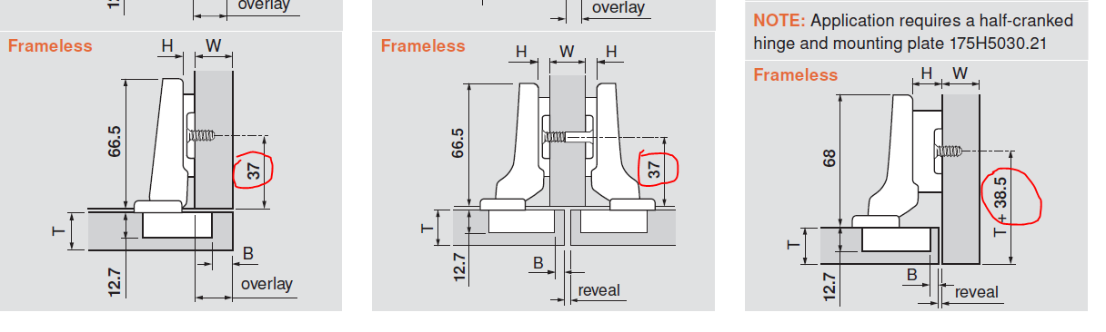

It seems that Microvellum only has one Global viable that reference the Hinge Plate inset from door (1.4567" = 37mm) . But per Blum's spec, the number is different (38mm)  when it is an inset door.
Shouldn't be there two Global Variables that will be used based on inset door vs non- inset doors?
