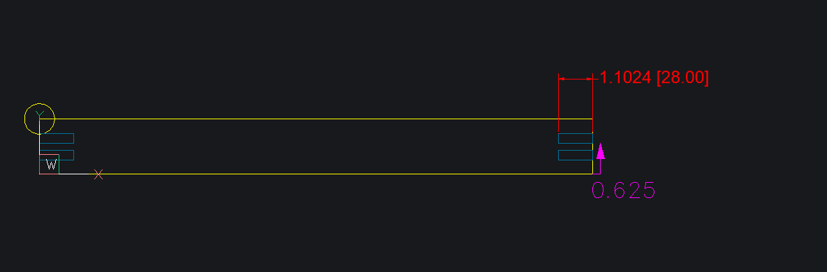

The dowel holes in MV are set to 28mm depth

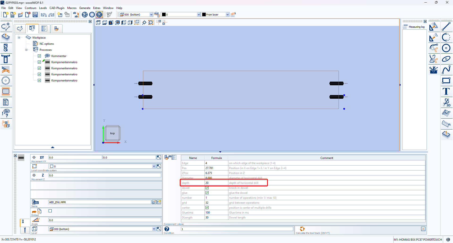

When I open the MPR file in woodWOP, the holes come in at 20mm depth. The holes stay at 20mm no matter what I change on the MV side.
The MPR file (notepad) shows a value of 28 for the depth
[H
VERSION="4.0 Alpha"
WW="6.0.98"
HP="1"
IN="0"
GX="1"
BFS="1"
GY="0"
GXY="0"
UP="0"
FM="0"
FW="200"
ZS="20"
HS="0"
OP="0"
MAT="WEEKE"
DN="STANDARD"
INCH="0"
VIEW="NOMIRROR"
ANZ="1"
BES="0"
ENT="0"
_BSX=455.027
_BSY=88.503
_BSZ=15.875
_FNX=0.000
_FNY=0.000
_RNX=0.000
_RNY=0.000
_RNZ=0.000
_RX=455.027
_RY=88.503
[001
l="455.027"
KM="Length"
w="88.503"
KM="Width"
t="15.875"
KM="Thickness"
<100 \WerkStck\
LA="l"
BR="w"
DI="t"
FNX="0"
FNY="0"
AX="0"
AY="0"
<101 \Kommentar\
KM="Units = Metric"
KM="Microvellum"
KM="Seq:#1.01 Drawer Sub Front - Base 3 Drawer > Jean"
<139 \Komponente\
IN="ABD_ENU.MPR"
XA="0.0"
YA="0.0"
ZA="0.0"
EM="0"
VA="Edge 4"
VA="Pos 27.781"
VA="ZPos 6.375"
VA="Diameter 8.000"
VA="Depth 28.001"
VA="dowel 1"
VA="glue 1"
VA="number 1"
VA="grid 32"
VA="center 1"
VA="inch 0"
VA="Komponentenmakro"
VA="ABD_ENU"
ORI=""
KO="00"
Any thoughts?
