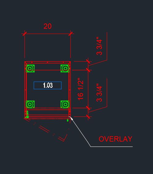

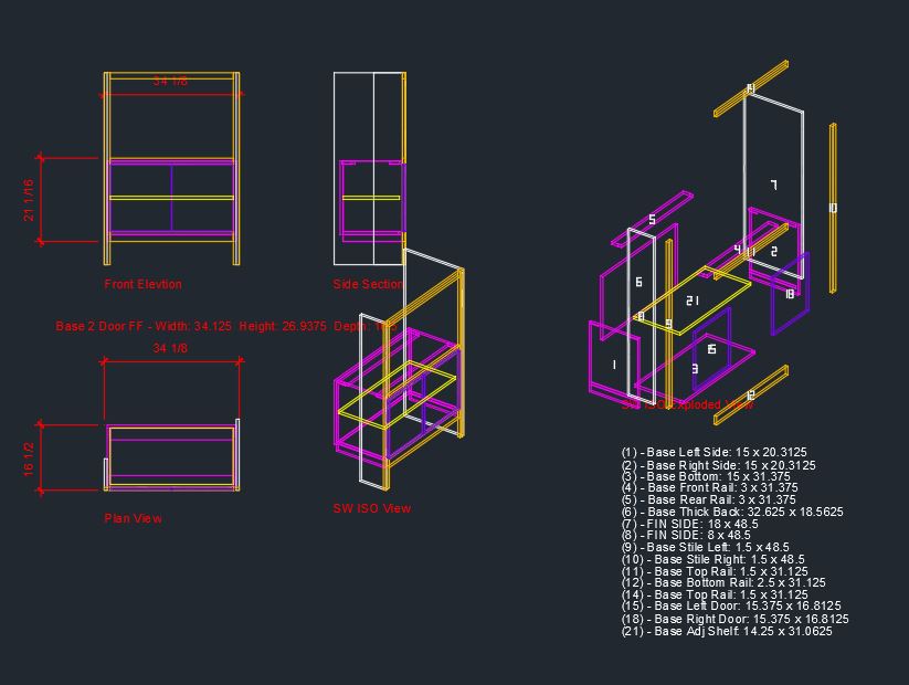

Example 2.
The default 2D drawing formats are not uniform, or presentable as generated. (see pics)  -Face frames originate with measurements in decimal while others show fractions.  Also, the placement of notes overlaps into the drawings in odd places.  We'd like to find a way to format them at the foundation level so we don't have to go and move things around in every 2D drawing.
Example 3.
Formatting the dimension style.  Like the spacing of the text above the dim line and the underscore on leaders and smaller dims that don't fit.  Again, been able to adjust those things at the drawing level, but need to find where to make that universal in the template.

flat/exploded view notes and dims
Face frame elevation
