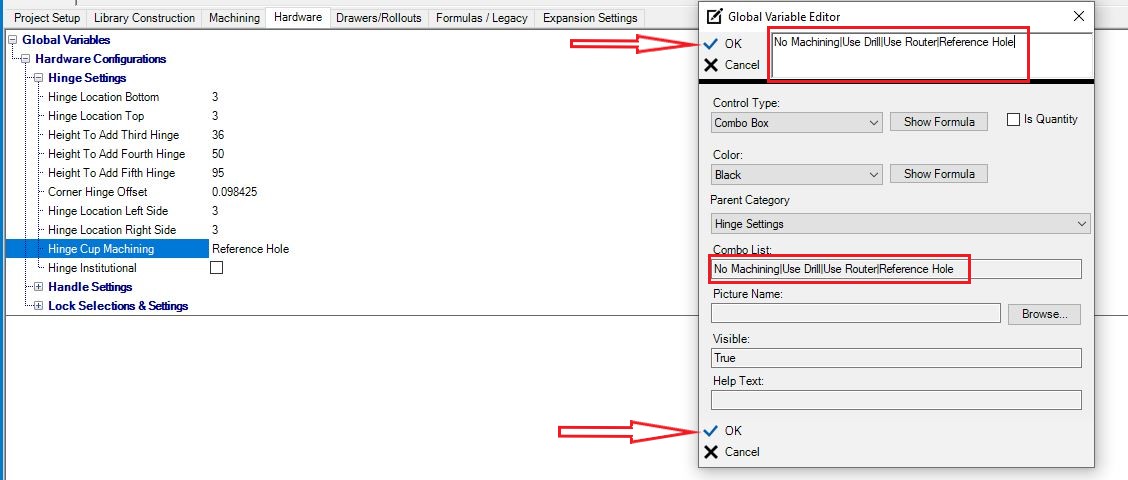

I started by adding this to the global variables. You can right click on Hinge Cup Machining and select "show Properties". Add "Reference Hole" to the list. Make sure to hit ok on both buttons or it won't save.

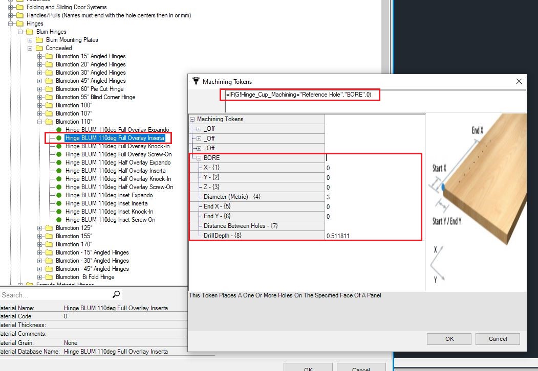

Head on over to a hinge in the hardware library. For us it's Blum 110+ Inserta which is what we use as a standard. Right click on the hinge and select machine tokens at the bottom. Add a token and use this formula on the first tab there. We use a 3mm bit to predrill for screws and pilot holes so that is what I use here.

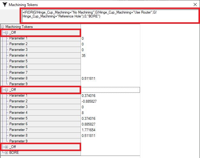

Next, select the first row/box of the other tokens and insert this formula so it turns off other machining. And you are done! Result is up top.
So now the question is, how can I add this to ALL the hinges under the Blum dropdown? I can't seem to do it in the H! workbook, library designer, or anything else. I really don't want to have to go through and manually add a token for every single hinge. Hope this helped somebody!
