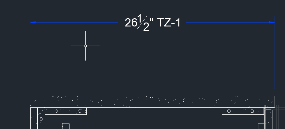

How do you adjust a DIMDRAW token, so the dim lines stop short.
What im trying to figure out is sometimes I'll have a dimension in a section or elevation where I want one pick point to be higher than the other but trying to get it to do this in MV dimtokens seems like theres more to it.

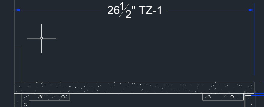

Ill have a scenario where i have a drawdim token on my section for my countertop. Now normally it draws the dimtoken at -4, but when theres a splash i have it raised up a little more.
What I would like is to figure out is how to get it so the Left dim line would be stationed a little above the splash or even better to just hit the wall and there would be no need for a dimension leader line.
