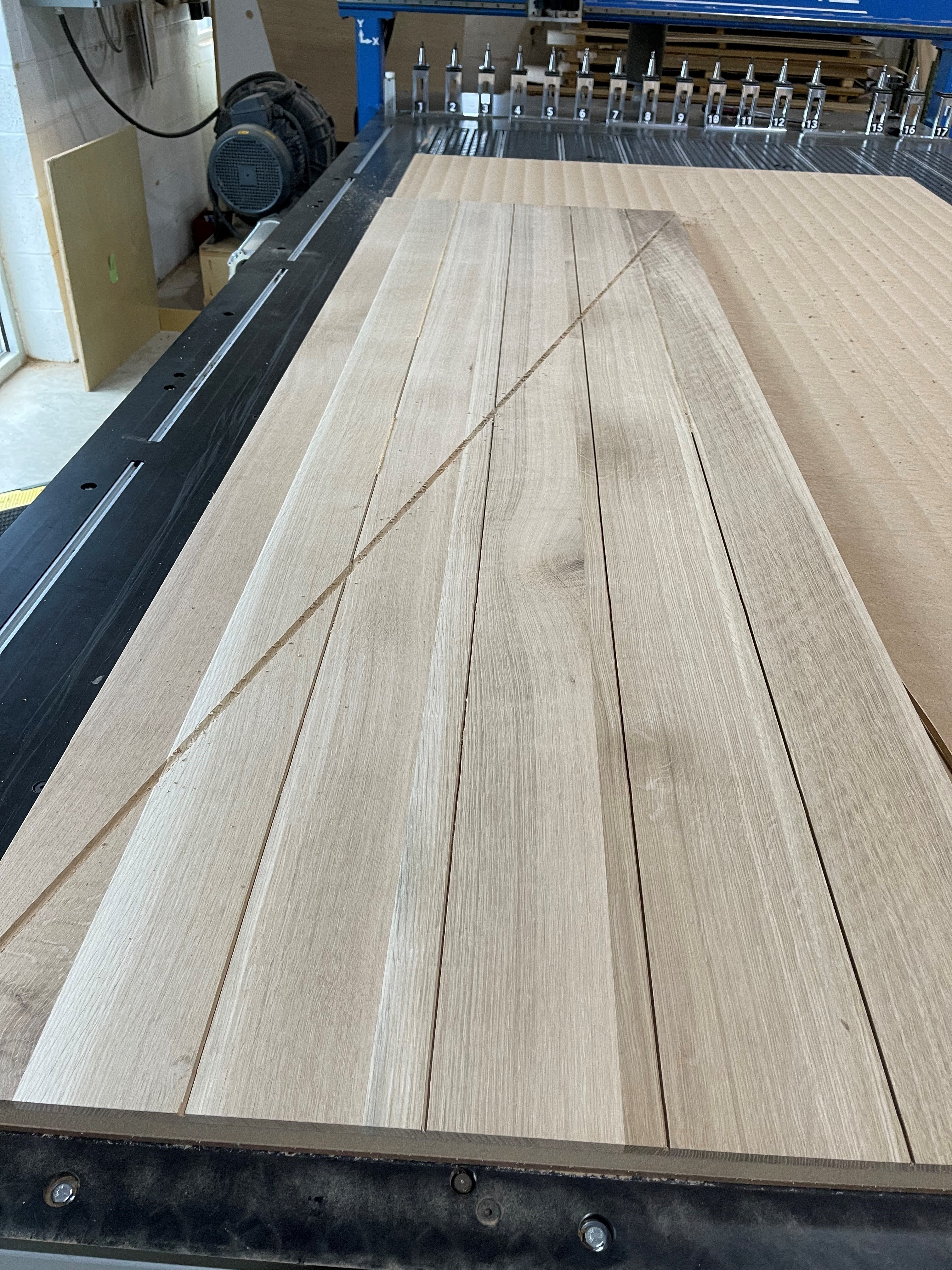

As the title says... We would like our router to go to the back of our CNC when the sheet is done. It comes to our home position which is in the way and we have to jog it back manually. We also just ran a 1.0625" laminated solid wood sheet and it just ruined it because the code is at 1" hard valued. See below. I want to change the height and XY position.

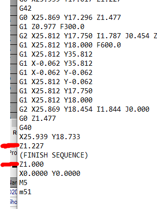

You can see here it allows for the tool safe height, but after it says [Finish Sequence] it drops to 1" and the 0,0

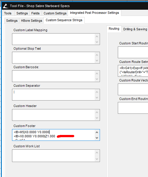

It looks like you can make that change here? But I feel insecure making that change with out knowing properly.
