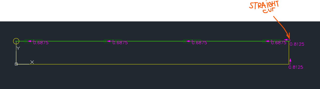

      For small parts we setup MV to leave onion skin. We are trying to implement Smartclips with Backsplashes. Problem is that we cannot clean the onion skin on the edge w/ Smartclips.
      So, we thought to add an additional straight cut that will cut thru the onion skin, but only on the edge with Smartclips. All well and done, however when we process the parts, MV recognizes that straight cut as part of the  Border, and ignores it. That is OK for all other cases but not here.
      I tried to adjust  the depth by .01" with no success.
      Is there a way to go around this?
Backsplash in 2D editor with the Cleanup cut:

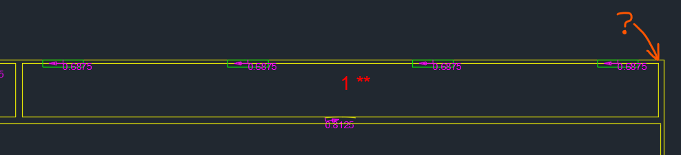

Backsplash in nest, no Cleanup cut:
