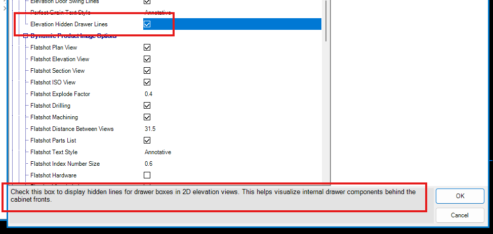

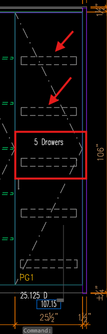

I'm sure this has probably been covered / talked about (maybe not and if so ... duh!) - But INNER DRAWERS / Rollouts in FL the GLOBAL VAR is MISSPELLED and does NOT drawing the dashed/hidden RECTANGLE!

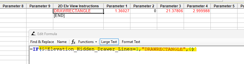

The default MISSPELLED var is Elevation Hidded Drawer Lines and it needs to ne Elevation Hidden Drawer Lines because 1) It's Hidden not Hidded and 2) the 2D Elev DRAWRECT token is looking for G!Elevation_Hidden_Drawer_Lines not G!Elevation_Hidded_Drawer_Lines
So rename your GLOBAL to HIDDEN or change your drawer box IF statement to HIDDED
