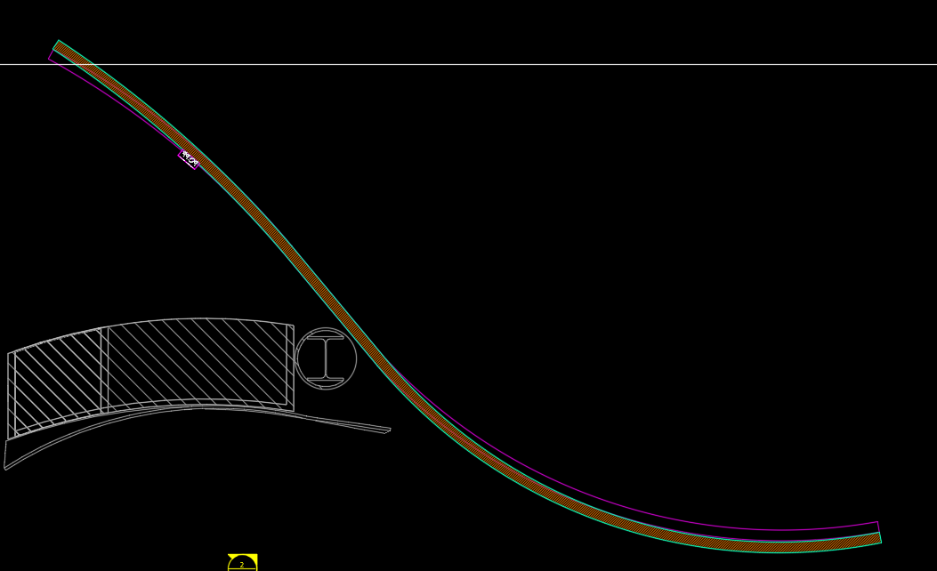

Usually Die walls follow one curve with top and bottom plates being  parallel to each other and  maybe offset of each other, with equal length studs.
I have a situation were Top and Bottom plates are the same but they are slightly rotated of each other. So the Die wall is twisted and as a result studs slightly vary in length. Plates are still in parallel planes.
Is it possible to model this with EPB?
This is a top view where you can see the slight rotation between the Top and Bottom plate.
