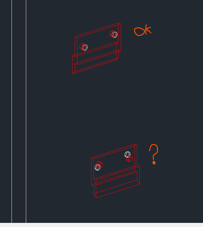

Machining For Associative Hardware Does Not Flip Correct From Face 5 to 6
Hello,
I am working on making Z-clips with associative machining. Started with an existing library hinge plate.   Problem is that placing the Z-clip on opposite face machining is incorrect. Is correct on Face5 but incorrect on Face. Hardware 3d block flips correct, machining does not. Machining only switches to other face, does not rotate with hardware block. Same as changing machining layer color from Green to Red.
This wasn't a problem with the hinge plate with which I started, because machining there was symmetrical. But Z-clips holes are asymmetrical. Is there a workaround around that? I do not want to make two Z-clips, one for Face5 and one for Face6.
