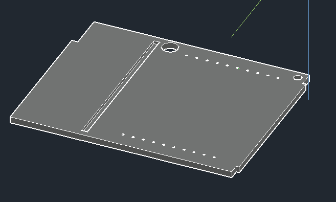

I have a division part that has a dado and thru holes (including line bore). For some reason it processes the dado as face 6 machining and we do not flip parts here. How do i get it to machine all on face 5? Also, we use tapered point drill bits as opposed to brad point so for drill thru pieces we need to go into the spoil board .15 to get it to drill all the way thru. i have changed this in the tool file but for some reason it still only goes thru .7448. i have been able to cheat it by changing the depth in the part machining token but i don't want to have to do this for all line boring. any suggestion would be helpful. part shown below
