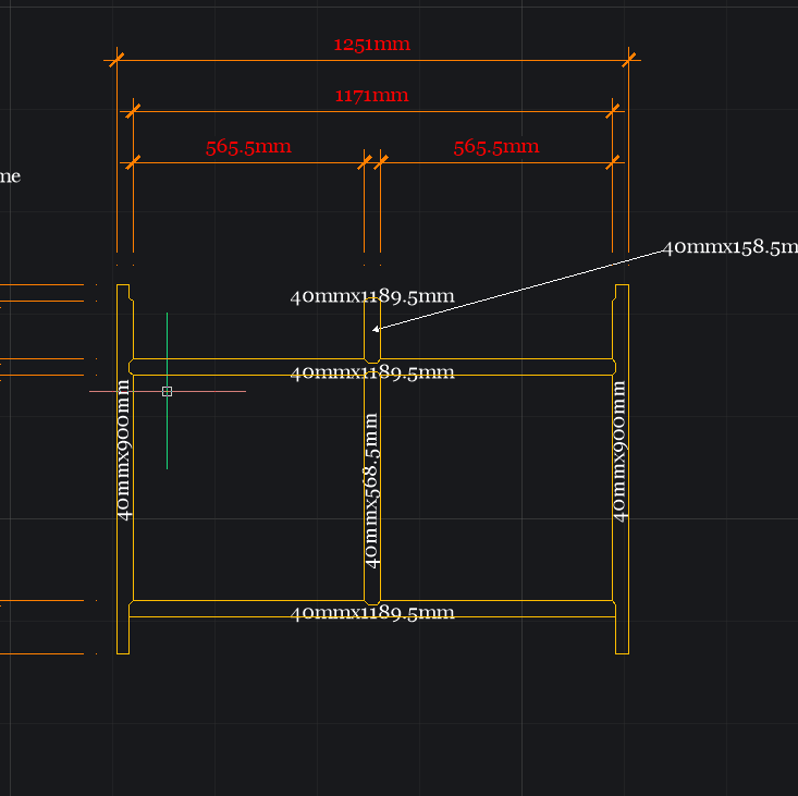

Hi in one drawing im working  on, all of the base cabinets are missing the top frame rails, how can i add them back in, i cannot see anything obvious or missing or broken in the design data, if i'm looking in the right places.
Update* ive tried new builds and old builds, and old projects and new projects and its happening across the board, have tested as far back as July, it cant be library related for that very reason either?
This is only for face frame drawing tokens the rail is there in 3d and works as expected, but this is causing errors on making reports which is where i first spotted it.
OEM is doing the same so it cant be software relataed, it must be setup/library data, i just cant see how it can effect old drawings with it!
FIXED! it was a custom name that caused the issue, at some point i mistakenly changed the name "base top rail" to "base top brace" i did this for stretchers and clearly had a brain fart and added it to the rail. So changing it back has cured my issue, but has also highlighted an issue with MV formula for pulling or adding names in this area. (i think) @Lenny Scianna
