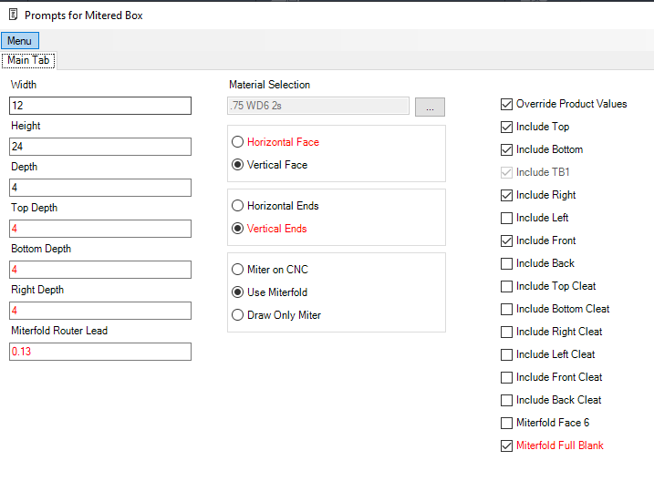

All Changed with sub assembly prompts and vert grain for example.

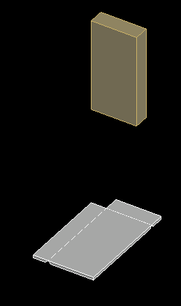

Front, Top, Bottom, Left, Right (All good)
Front, Top, Bottom, Right (Still Ok ...)
Front, Top, Bottom, Left (All good)

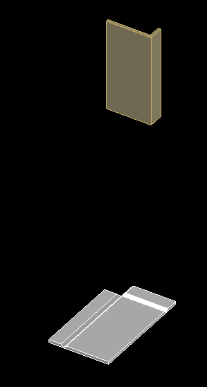

Problems seem to start here:

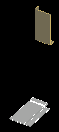

Front, Bottom, Left (Umm ... Wrong when folded!)
Front, Bottom, Right (Umm ... Wrong when folded!)
I think just these 2 states are flipped??

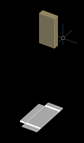

Front, Top, Right .... (Now it flips to FACE 6?)
And not correct either

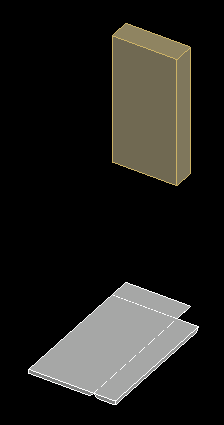

And changing to HORZ grain it's still flipped BUT appears to be folding correctly?
