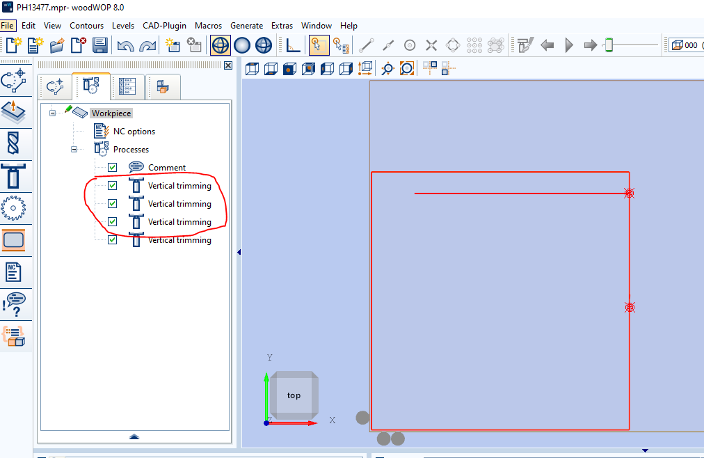

multi pass tools converting to woodwop mpr with single vertical trimming not multiple

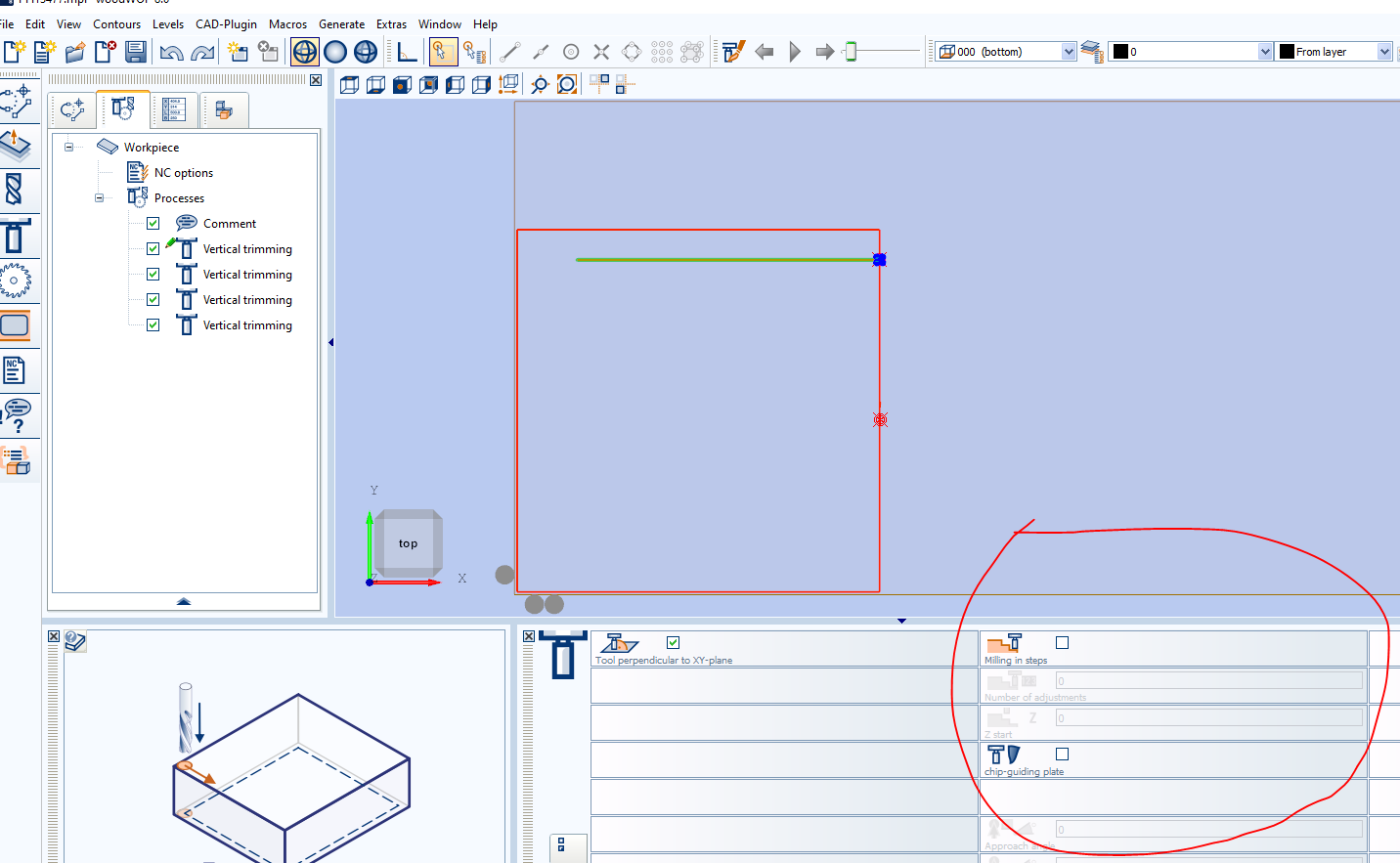

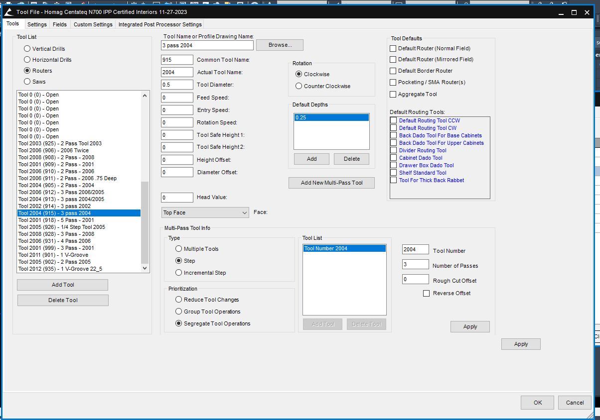

does anyone know how to make Microvellum multi pass tools convert to woodwop mprs in single operations and not multiples as it is does. Example if I have a 3 pass multi step tool it comes up as three seperate vertical trimming commands. Can there be a custom string created to the IPP or can this only be done by using the step option in woodwop and turning off the other trimming commands. Will there have to be a custom string created for all of our multi pass tools as well regardless of multi pass tool info or prioritization settings
we are trying to accomplish this to streamline everything out to our machines to save time in the office and out on the shop floor too. any advice or knowledge would be appreciated.
