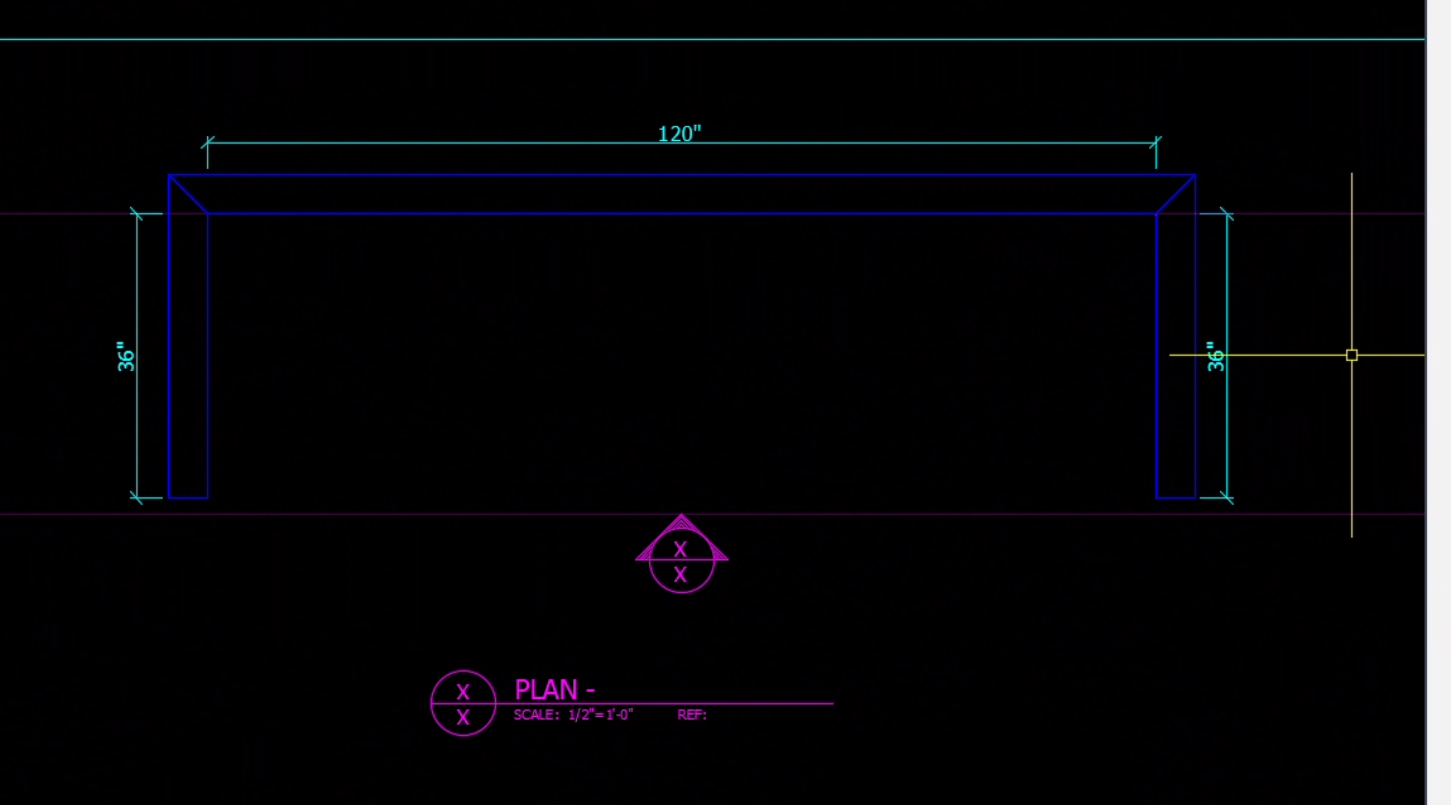

Hello,
I am in a new position and they are a bit behind when it comes to the MV ease and utilization.
I'd like to have hatches come in when laying down my walls. I went to the prompts of the wall and it does have hatching checked. Any ideas on what the problem could be?
I would also like the dims that come in to either go away or associate to the Annotative dim styles I've created. I'm trying to eliminate the massive amount of manual 2D that is being done, so that we can save time.
Also, is there a way at a master level to make these changes so it applies to all our MV seats, not just mine?
Thanks in advance - C
