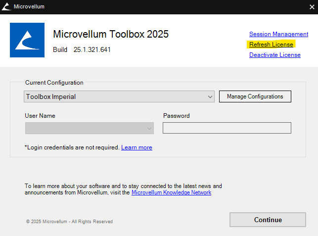

Some users updating to the latest Toolbox build (25.1.0519.641) with SLA-type licenses have reported temporary loss of access to certain modules. This is due to a coding change in the build that interacts with the updated automated module-enablement process. Because SLA licenses refresh less frequently, they may not immediately register the change. To resolve the issue, click "Refresh License" on the Toolbox login screen, then restart the software. The updated license should restore module access.
