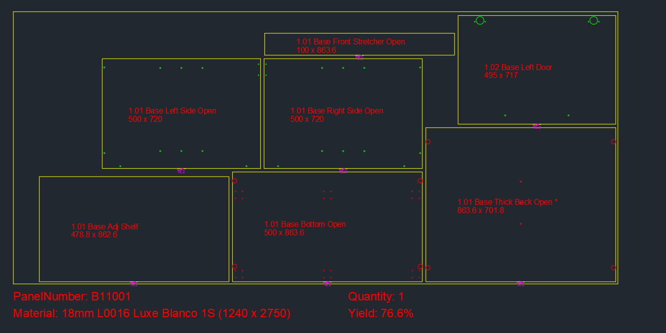

ive drawn an open cabinet and when i nest it, the face material is allocated to outside and not inside the cabinet.    is there a setting somewhere i can change this,   i would assume an open cabinet would automatically put the face material on the inside of an open cab.   ive nested it with a 1 door base so i can check.  as you can see the hinges on the back of the door are on the same layer as th shelf studs for the open cab.  and the legs and cams (should be on the outside) are being drilled on the secondry drilling programs on face 6 face
