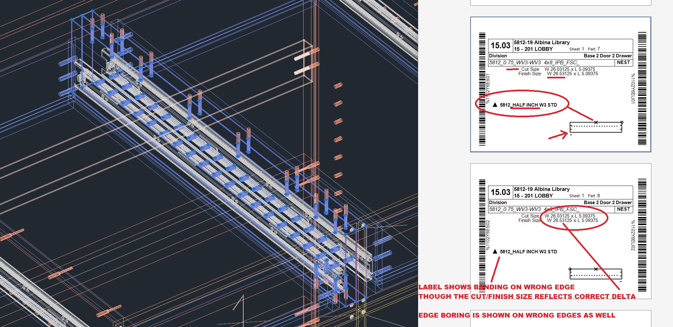

Part Labels: Boring and banding shown on wrong edge

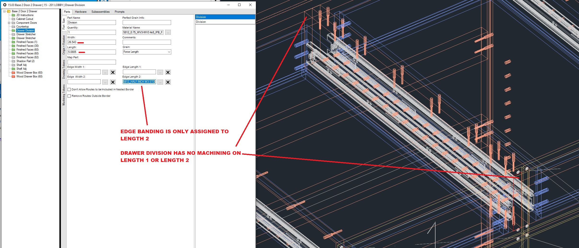

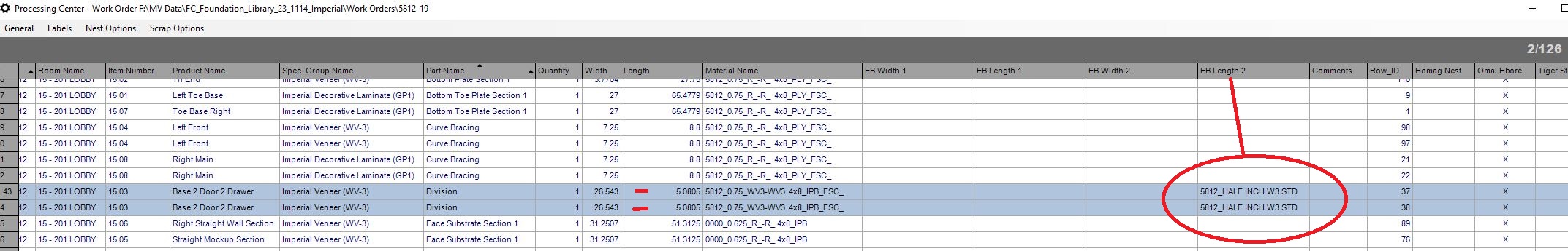

Occasionally (maybe 50% of the time?) we end up with banding call outs and edge boring labeled on the wrong edge. It seems to only manifest on "Drawer Divisions" but not reliably wrong. No clue how to track down what's causing this. The info shows correctly everywhere but the part labels.
It's unpredictable, as when I process these same parts in another batch, the labels show the correct info.
Images below show the instance of bad label info:
