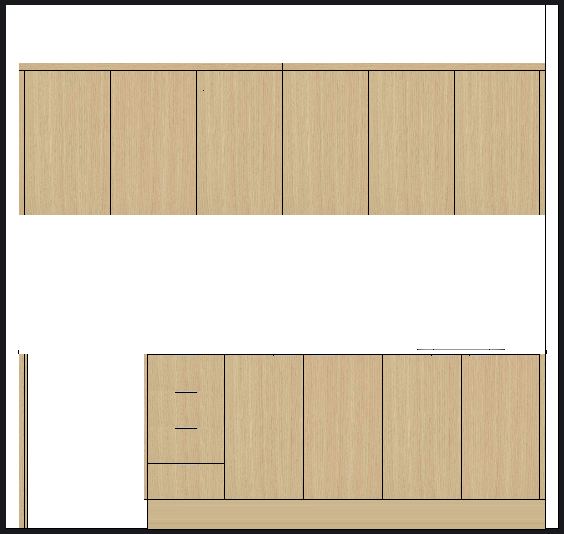

I am trying to nest a job and have the drawer fronts perfect grain
  1. Doors : Vertical Grain
  2. Drw Fronts: Vertical Grain
  3. Kickfaces: Horizontal Grai

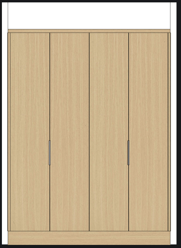

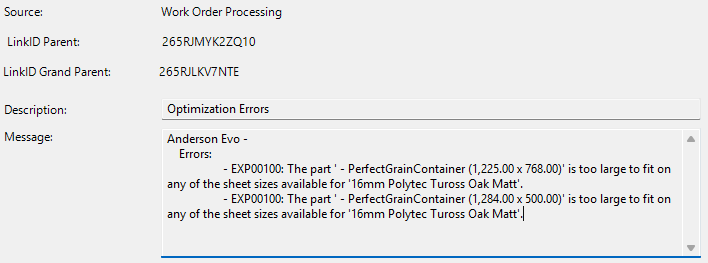

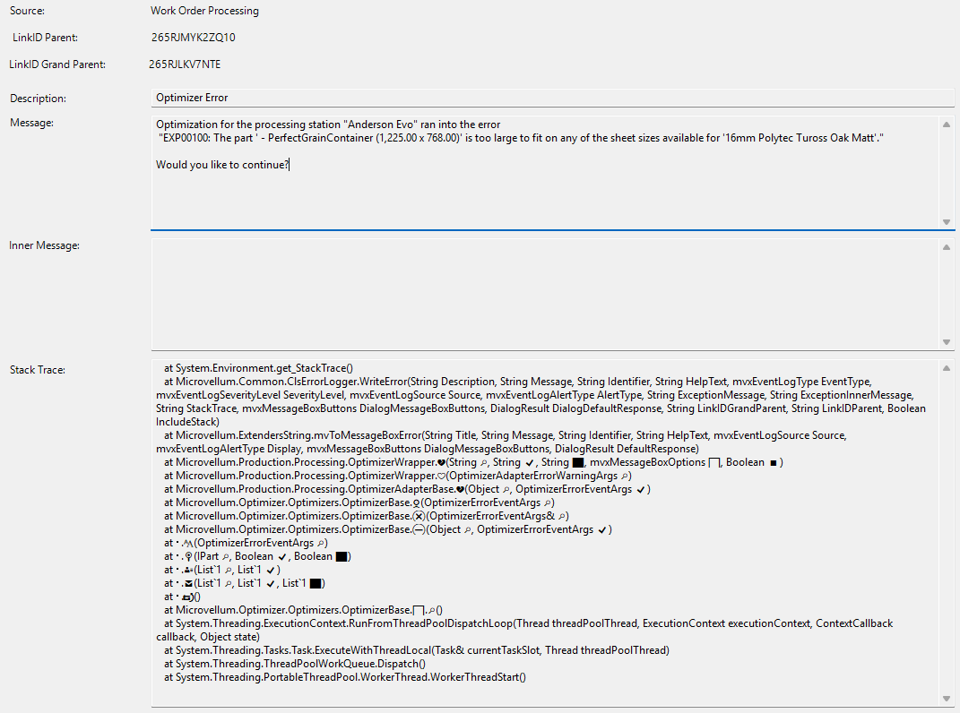

It keeps failing because its putting a Left Filler | Left Door | Right Door | Right Filler together causing the Perfect grain container to go over the maximum width of the sheet.
When the grain is running vertical for doors, it doesn't need to be grain matched side by side only up and down.
