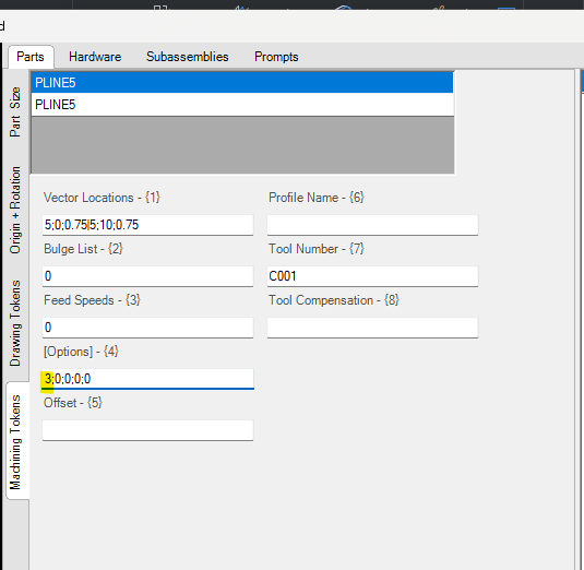

I have notice a potential issue with the PLINE token, or at least a functionality I can't find documented. Our PLINE tokens are being generated by Edit Part in 2D with a value of "3" for the argument that controls whether the token is Machine + Draw, Machine Only, or Draw Only. The Machine Token KB article and the help text blurb in the Part Properties editor both agree that the valid values for this argument are 0, 1, and 2. I'm wondering where the "3" is coming from. I've only noticed because we're starting to set up Specialty/Profile tools, and the drawings don't come in correctly with this value being set to "3".
Am I missing something here or is this a bug?
