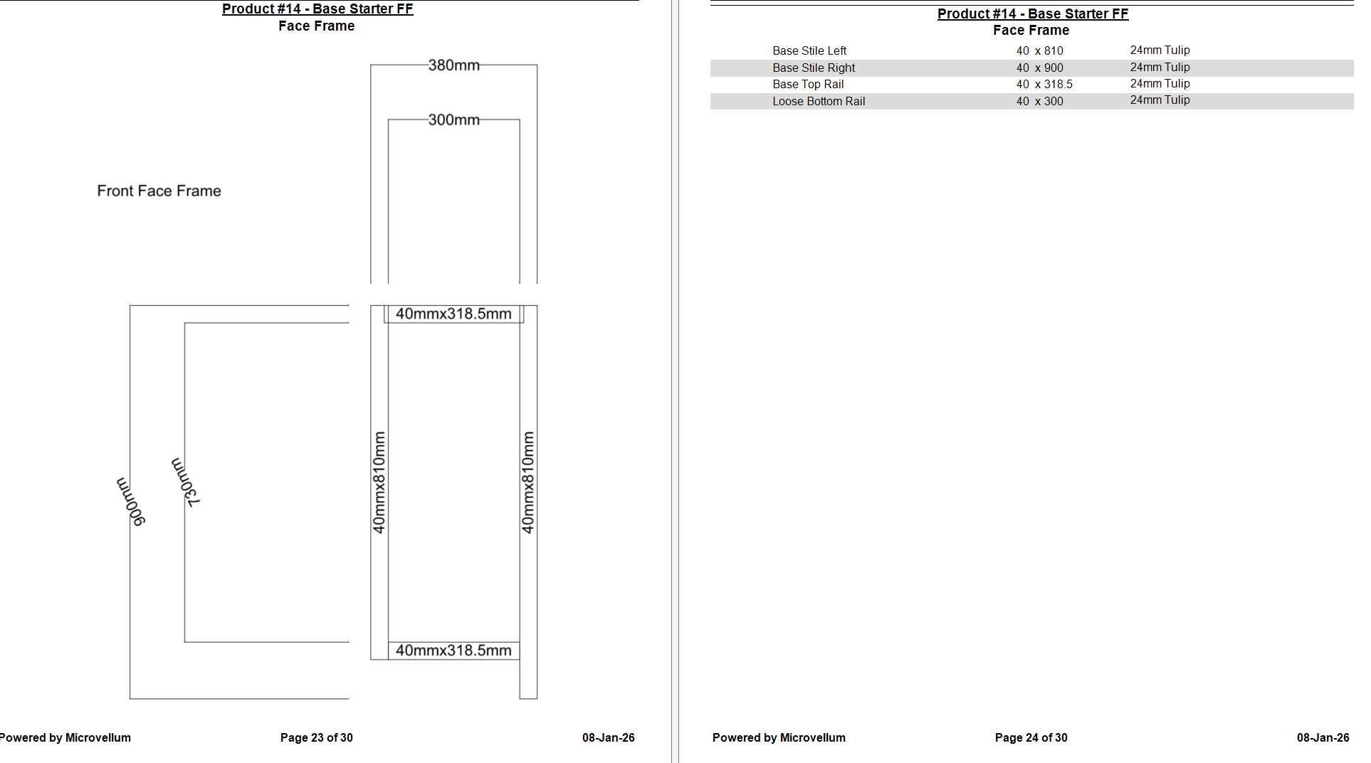

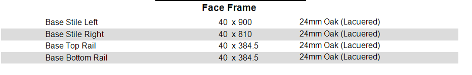

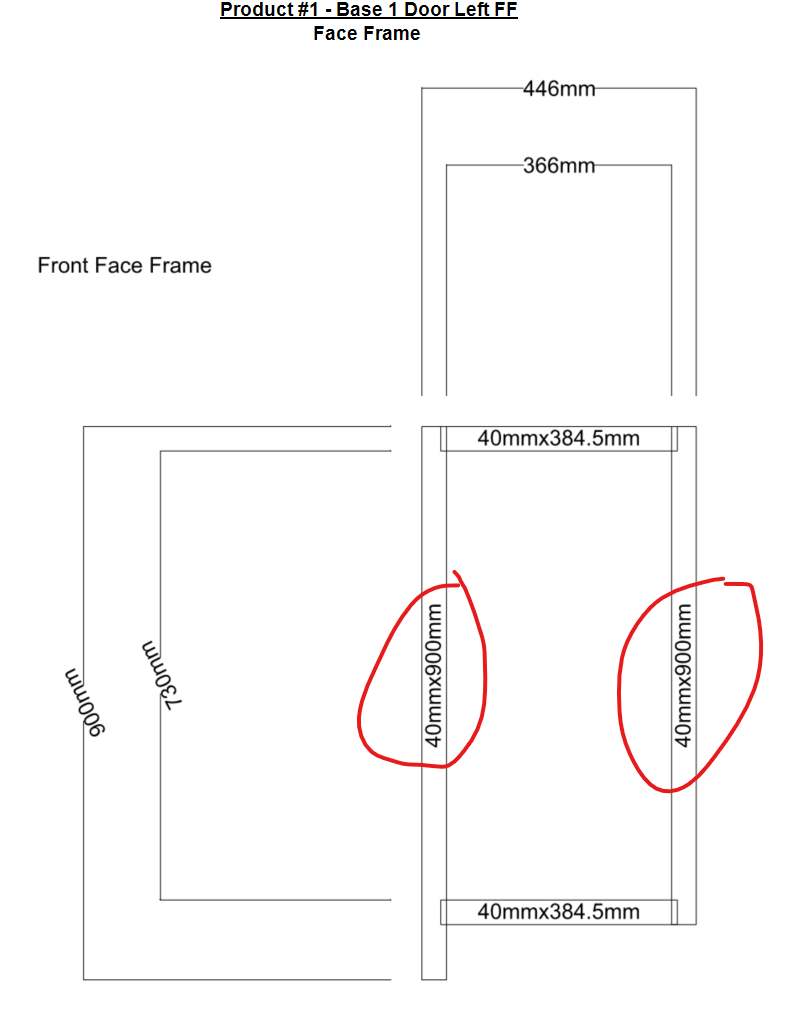

As per the title you can see the drawing tokens that are in the reports, or something to that effect are not correctly being passed over. And yes i do want them different heights like that for this particular job and scenario. The list is correct the image sizes are not. It appears to just be using the left stile sizes, assuming they would be all the same.
Same can be seen in the top and bottom rail of the last image, yes they must be different, in a perfect world we dont need the list to be printed its a waste of paper and ink, but we have to do it right now.
