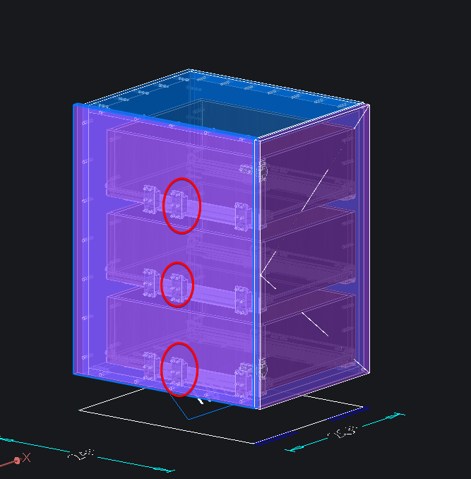

  1. I added a 3rd drawer spacer to the "wood drawer box" sub-assembly.
  2. I saved this  sub-assembly change to the template
      When I create a new project all of my modifications are working correctly
However, on an existing project it is not.
  1. I have updated all spec group components (wizard, global, etc..) from the template.
  2. Issue: The sub-assembly updates are not there when i draw a new cabinet (in the existing project)
